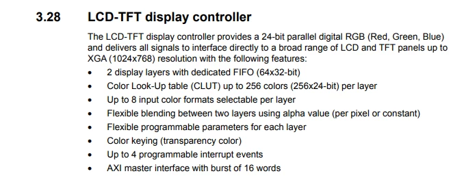

I'm starting a project that uses a 1024x768 graphics display and I was wondering which STM32F MCU  (LQFP 176pin) would be the better to drive the RGB Panel. I would be using external memory but if there is a MCU with internal memory that can display 1024x768 that would be easier and would make the project cheaper as well.

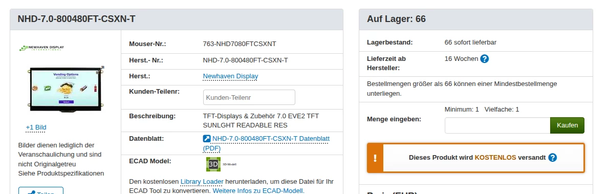

So for a GUI , and using a "small " cpu (compared to the SOCs used in mobile phones) , its good idea, to use a display with onboard graphics and frame buffer , so the cpu just giving graphic commands to the display, connected with a SPI .
I use the TFTs with EVE graphics, the TFT has almost same price range as a plain "***" TFT frame.
Just look at mouser...
btw 1024x768 seems very unusual , more is : 800x480 , 1024x600 or 1280x800 ;
https://www.mouser.de/c/optoelectronics/displays/lcd-displays/?diagonal=7%20in%7C~10.1%20in&m=Newhaven%20Display%7C~Riverdi&instock=y&sort=pricing&pg=2

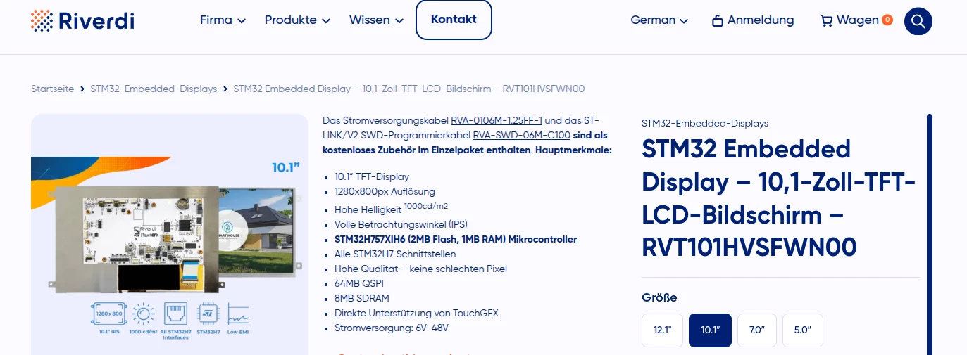

or look at displays, with STM cpu already there...
https://riverdi.com/de/produkt-kategorie/stm32-embedded-displays-de?sort_order=_sfm__regular_price+asc+num
... many others also, just ask google :)

Thanks for the info but it's not what I'm looking for. They have 8080 or 6800 16bit interfaces which is just to slow for our project.

with RGB par. -> maybe STM32H7R3Z8 , 144pin lqfp.
