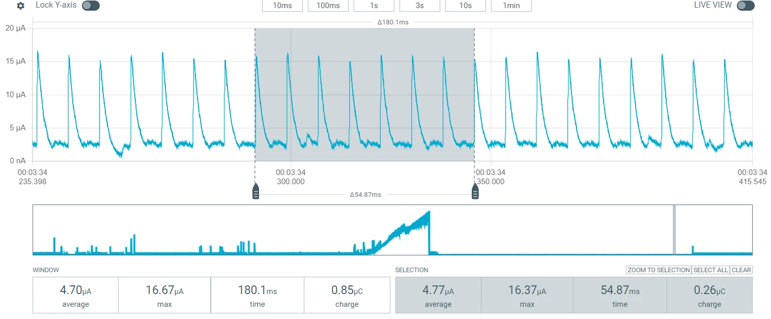

The LCD Driver in stm32u083rc is consuming more power in stop 2 mode, it is taking more current at every interval (interval is of refresh rate , if refresh rate is 128Hz then the spikes come at  (1/128 = 7.8ms))

the below i have attached the power consumption in graph we can see the spikes clearly

I am using stm32u083rc and using stop2 mode, clock for LCD is LSE (32.768 KHz) no backlight, and we need LCD to be On all the time, we cannot disable it , currently in stop2 mode the base average current with LCD enabled is 5.7uA, and with LCD Disabled the current is 2uA. so because of those spikes when LCD is enabled it is increasing the base current to 5.7uA. we are keeping LSE on during stop2 mode. we are putting unused GPIO to analog mode and driving necessary pins to known levels using pullup or pulldown during stop mode .
The major doubt is regarding the current spikes going up-to 20-25uA based on the refresh rate interval selected for LCD ( though the average current is 5-6uA only)
You can clearly see periodic current spikes corresponding to the LCD refresh intervals. The average current remains around 5–6 µA, but these periodic spikes are preventing us from reducing the base consumption further.

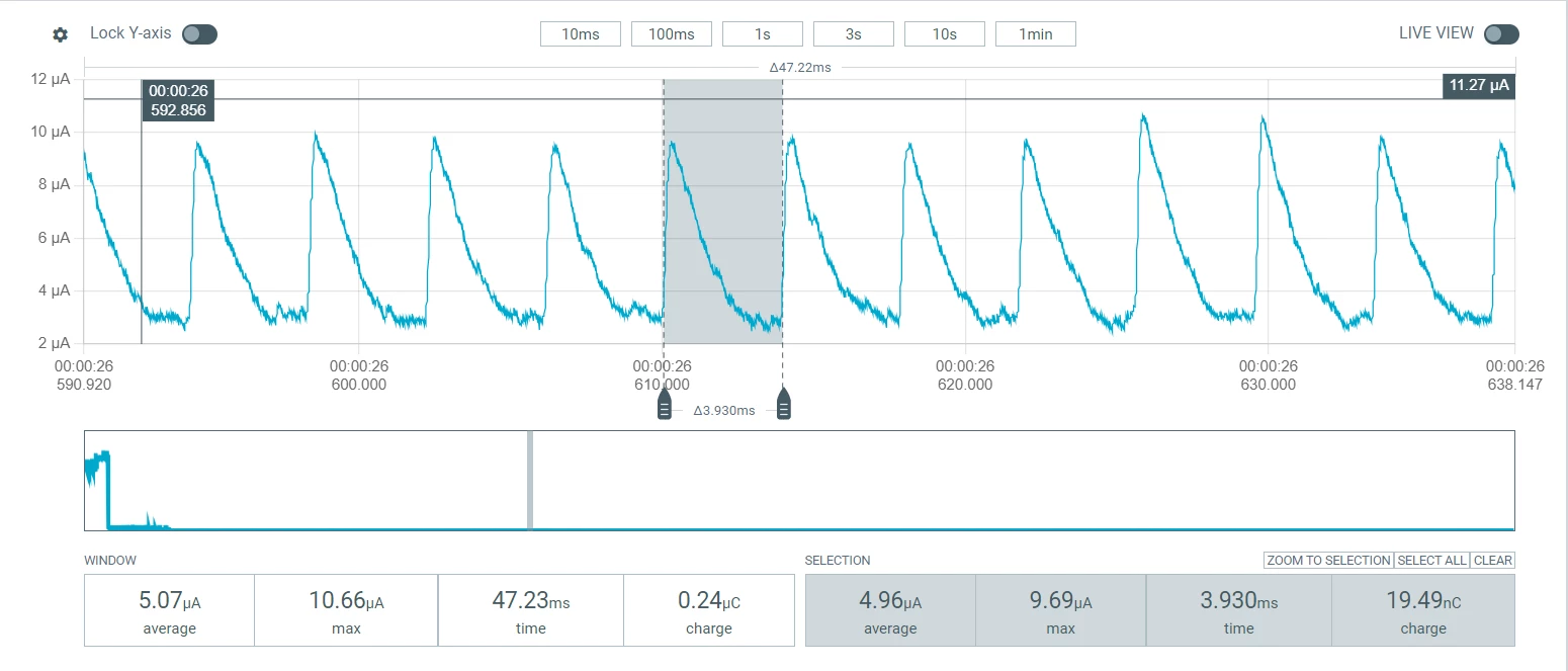

  • STOP2 with LCD Enabled: ~5.07 µA average( 7uA-8uA spikes)
  • When LCD is enabled, there are current spikes of  7-8µA at regular intervals (depending on the LCD refresh rate).
    • For example, with a refresh rate of 128 Hz, spikes occur approximately every 7.8 ms (1/128).
  • The average current increase is mainly due to these spikes.

Power Measurement Graph
We can see periodic current spikes corresponding to the LCD refresh intervals. The average current remains around 5–6 µA, but these periodic spikes are preventing us from reducing the base consumption further.

Viktor POHORELY
October 3, 2025
spikes are expected behavior - LCD is behaving as set of capacitors, with each refresh of LCD leads to charging them. This is the main reason for spikes in the consumption of current. It depends mainly on the parameters of LCD glass.

SumukhaAuthor
October 8, 2025
Even when the LCD is removed, the lcd driver is consuming power, we are using ST internal LCD Driver.
the connection of lcd is not making any difference in the power consumption.
