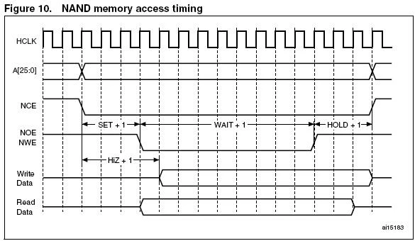

    Did somebody use FSMC to drive LCD in Motorola 6800 mode eg. with controllers HD44780 or KS0108 and checked it if this works?
    It is possible to use NAND gate to transform Intel 8080 into Motorola 6800 but in Application note TFT LCD interfacing with the high-density STM32F10xxx FSMC, ST wrote that it is possible to use negated NEx signal as E. I'm not sure if timings are correct for this?
    Did somebody check it?

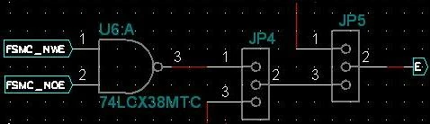

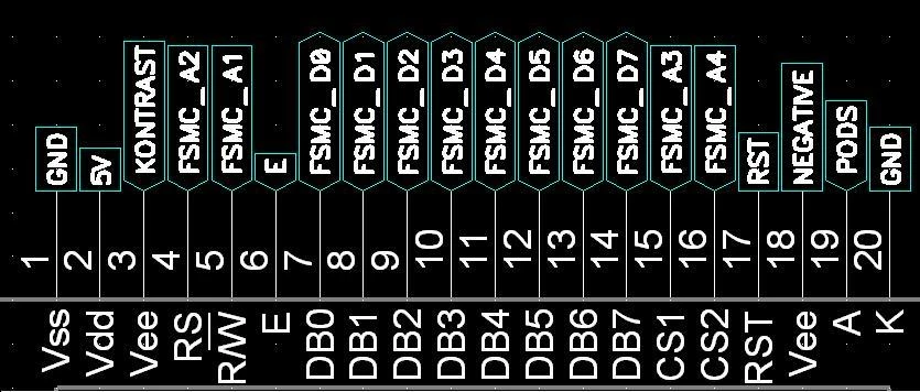

    I post schematic diagram, as you can see I use addresses lines to set RS, RW and other control signals. I hope to have only one instruction to control the display.
    I will give you information if I will have a success :)

    Hi back,
    Your figure summarizes your objectives nicely.
    A few cautions:
    a) ''E'' generation - you want this to be qualified by ''both'' NCE and NWR - only when both of these go low will ''E'' strobe high. For safety I suggest that you start this pulse around 500 or so nS. (as you gain confidence you can shorten it) You must guard against this strobe occuring illegally - you will see garbage on the screen when this happens.
    b) All of these displays must be initialized - often the first such instructions must have ''extreme'' delays (40-100 mS) - be sure to comply.
    c) Be sure ''not'' to tie the micro's NWE to the displays R/W line. (will violate RW set-up time)
    d) To avoid the insertion of variable time-delays you may choose to ''read'' the display's ''busy-flag.'' In this way you insure the fastest data transfer to the screen - important when you move up to larger, more pixel intensive screens. (tft-color) Your read of the ''busy'' may capture your processor for 1.6mS (worse case) after a display clear.

    Thanks a lot I did similar investigation. I it possible to use NAND gate mode and get more than I need for this chip. The only need is to use NAND gate to transform WR,RD into E.
    And we have 256 cycles of HCLK (3.5us) for hold, wait and setup time. I think this will work but I can not have a possibility to check it before PCB.

    Quote:
    Have concern that ''NWE'' and ''NOE'' (which are nand'ed to form positive going ''E'' strobe) are NOT qualified by an address decode - thus you will generate ''E'' illegally!
    Thanks for showing me that problem. I thought that FSMC generate WR/RD signal only if I write or read form addresses of memory that belongs to FSMC. Now, I understand why ST uses hardware NE1 as chip select.
    I will reconsider this solution (try to explain my boss that is not worth to do that) and maybe back to the standard solution - steering all signals using GPIO.
    Do you think it is worth to do that using FSMC?
    [ This message was edited by: jaroslaw.oska on 07-09-2008 16:35 ]

    Very nice drawing. Have concern that ''NWE'' and ''NOE'' (which are nand'ed to form positive going ''E'' strobe) are NOT qualified by an address decode - thus you will generate ''E'' illegally!
    Sorry if I've missed something - we used to generate unique address - decode it - and then gate that adr. decode with WR or RD to produce ''E.'' That unique adr. decode is what I don't yet see/understand in your drawing. Trying to prevent you from a hacked pcb...

    1) Possible, Illegal Lcd ''E'' strobe generation:
    My firm does not have an FSMC device yet - all my work with you is from FSMC reading/theory - I am highly experienced with displays. I continue to believe that you will be safer to ''better'' qualify your ''E'' strobe - so that only an ''exact'' pair or limited range of addresses will trigger.
    It may be possible to create a rare, extreme address - and decode it with simple and/or gate. (I recommend this - don't stuff the parts if my illegal E hunch is wrong)
