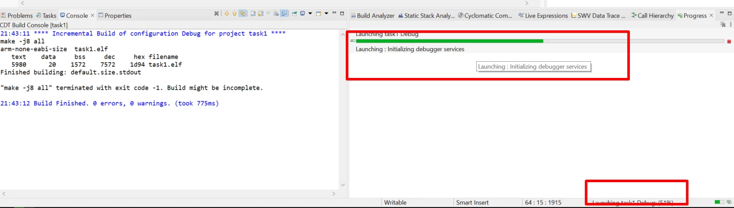

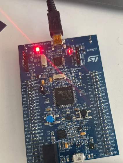

Dear all,
I am new to STM32 development environment. I recently purchases STM32F407G-DISC1. I also purchased mini USB cable. When I connected the board to the PC, I can see that LD1 is on (RED). I can upgrade the driver for ST-Link as well. So, I am assuming there is connection established between board and the PC. Then, I write the first piece of code as attached below to see the LED blinks. It compiles very well. However, the code is not downloaded to the board. When I click on debug, it stucks at Launching: Initializing debugger services. It does not complete the progress. Please see the attachment2. I am helpless on this and require immediate support. I really liked the board and dont want to lose the enthusisasim.

    Hello @demir and welcome to the ST Community :smiling_face_with_smiling_eyes:.
    Since the LD1 is on RED that means the communication between the ST-LINK/V2-A of the board and the PC is not established.
    I suggest you to check your usb cable (try using another one) . Also, try to use another USB port for the communication.

    Thank you for the answer.
    I have changed the USB port but the issue persists. I am using this cable (MP01787), do you think this is not the proper one ? Could you please suggest me the right cable ?

    Dec 13, 2023 6:44 AM UTC
    It didnt work either. I dont know if this is a sign but I can see that virtual com port is visible.
    Is it due to the cable ?
