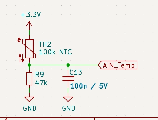

L412 ADC gets different results on consecutive reads
I am using STM32L412KBU and read in different ADC channels.
Now I see that the first read returns 23451, the second read immediately after returns 20338.
I use x16 OVS, hence the big numbers.
After the second read, values seem to become stable.
external circuit is as follows

Peter BENSCH
Peter BENSCHBest answer
February 9, 2024
Anyway, the time constant of the resulting RC network is well into the millisecond range due to the 100nF, which must of course be taken into account. A pull-up in the order of 40kohms will also have a significant influence, which is why you need to give the system enough time to settle.

b.a.
b.a.Author
February 9, 2024
the above was in debug-mode with breakpoints...
if I let the code run normally, just a consecutive read is not enough, the values decrease only slightly from one read to the next.
To get to stable values, I have to add a 10ms delay at least
Peter BENSCH
February 9, 2024
Well, since in your case it is a high-impedance temperature measurement with some significant capacitor, which is therefore very slow, you should set the ADC from 2.5 cycles to the slowest 640.5 cycles.
Regards
/Peter
b.a.
b.a.Author
February 9, 2024
well, my thoughts went that way too
But I reasoned that it should only be relevant after powering up the system, not when it is running and I merely reset the controller...
changing to 640,5 cycles did not change the behaviour relevantly
b.a.
b.a.Author
February 9, 2024
I also notice a drastic change in returned ADC value depending on if and where I set a breakpoint before the read.
Setting a breakpoint before the GPIO gets set to analog (line 1 in the below code) returns 39897
line 5 : 19913
Might this be because the pin was configured as input with pullup right before?

b.a.
b.a.Author
February 9, 2024
so this behaviour can be explained by the big capacitor and the fact the just before, the pin had the internal pull-up connected?
Peter BENSCH
February 9, 2024
Just give it a try.
b.a.
b.a.Author
February 9, 2024
I now left all the relevant pins in RESET_STATE and ADC readings are "immediately" correct!
Initializing them as GPIO_ANALOG has of course the same effect
Thanks for pointing me in the right direction!
