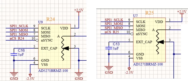

'L031 SPI master with multiple AD5271 slaves
Our board has an STM32L031 as a SPI master with two AD5271 Digital Pots (R24 and R25) as SPI slaves.  After power-on both digital pots can be read (return default of 511).  The first digital pot accessed can be given a new value and that new value read back.  The other pot now reads all zeros.  A different value can be written to the first digital pot and read back (so the SPI bus didn't get 'stuck' after the write routine finished).  Once the second digital pot is given a new value, neither digital pot can be read back (returns all zeros).  It doesn't matter if R24 is accessed first or if R25 is accessed first; the first pot accessed can be read-modified-written.  A UART port provides debug output:

The nCS pins to the DigiPots are just general purpose GPIO's with the SPI port NSS in software controlled mode.  SCK is 500 kHz (verified on 'scope).

- No interrupts are being used in the application, everything is just busy-waiting using the HAL_SPI_Transmit() and HAL_SPI_TransmitReceive() library functions.
- There is only one SPI port in use with all MISO lines tied together, all MOSI lines tied together, all SCK lines tied together, and the two DigiPots nCS lines tied to individual GPIO output pins.
- The SPI controller doesn't 'know' to what device it is communicating since the nCS lines are handled by HAL_GPIO_WritePin() function calls.
- The GPIOB and SPI1 registers are the same (as inspected with STLINK and STM32CubeIDE) when the code works as when the code fails.
Questions:
Q1) Why does a dpotSetRDAC(R24) call make subsequent dpotSetRDAC(R25) calls fail?
Q2) Why does the code only work out of power-on and not from STLINK debugger reset or nRESET hardware reset?
Q3) Are Q1 and Q2 somehow related?

The answer is in the AD5271 datasheet under "SDO PIN AND DAISY-CHAIN OPERATION".  The SDO pin needs to be set to high-impedance before changing to communicate with a different AD5271 by writing 0x8001 and then 0x0000 to the AD5271.  The nSYNC line does not automatically set the MISO line (SDO) to high impedance.
Answer1) The first AD5271 pulled the MISO line low at the end of the SPI bus cycle since the Hi-Z command wasn't sent.
Answer2)  The AD5271 needed a power-on reset, not the STM32, to get the SDO line back to Hi-Z.
Answer3) Yes -- same root cause, namely that the AD5271 requires a software command to tri-state the SDO pin.  Just negating the nSYNC signal is not enough.
