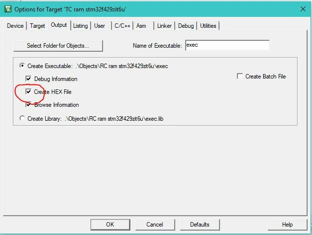

Dear all,
              i want to generate .hex or .bin file using Keil-MDK ARM  for external NOR flash connected with STM32F746NG in STM32F746G-Discovery Kit. I know how to program both after getting generated but i don't know about how to get any one of them generated from Keil-MDK ARM.
  Please! kindly elaborate me the steps to achieve this. I tried on my level best but need guidance.
THANKS
    2 replies
    Bob Boys
    Visitor II
    July 25, 2017
    Posted on July 26, 2017 at 01:50
    Hello
    It sounds like you need the fromelf utility.
    Please see:
    http://www.keil.com/support/docs/3213.htm
    Bob

    Posted on July 26, 2017 at 08:42
    hello!
