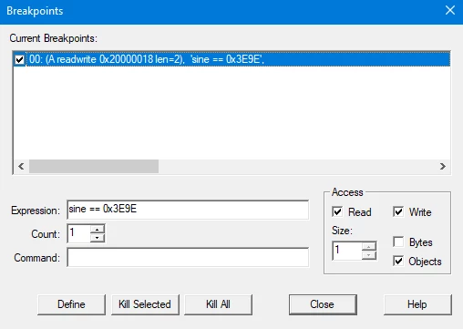

here is my conditional breakpoints settings
I took exercise as <apnt_230.pdf> did at page 11, 15) watchpoints: Conditional Breakpoints.
The application can use conditional breakpoints. Why I can't? I got a dialogue saying that My
target device dose not support conditional breakpoints!
Actually, I am using the STMF407 Discovery board as the
<apnt_230.pdf> using.
So, why?

    Finally, I found I forget to check the box of Read and Write.

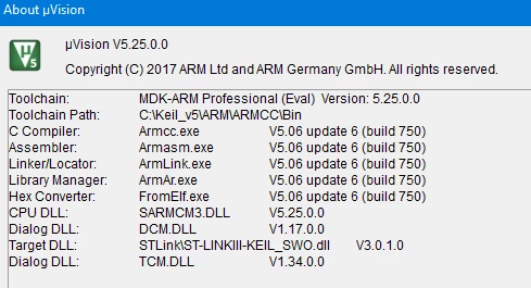

    William chang
    Feb 11, 2018 4:06 AM UTC
    Posted on February 11, 2018 at 04:06
    SB12 is connected as default.
    My ST-LINK firmware updated recently. Version: V2.J29.S0
    Here is my KEIL IDE details:
    William chang
    William changAuthorBest answer
    Feb 11, 2018 9:21 AM UTC
    Posted on February 11, 2018 at 10:21
