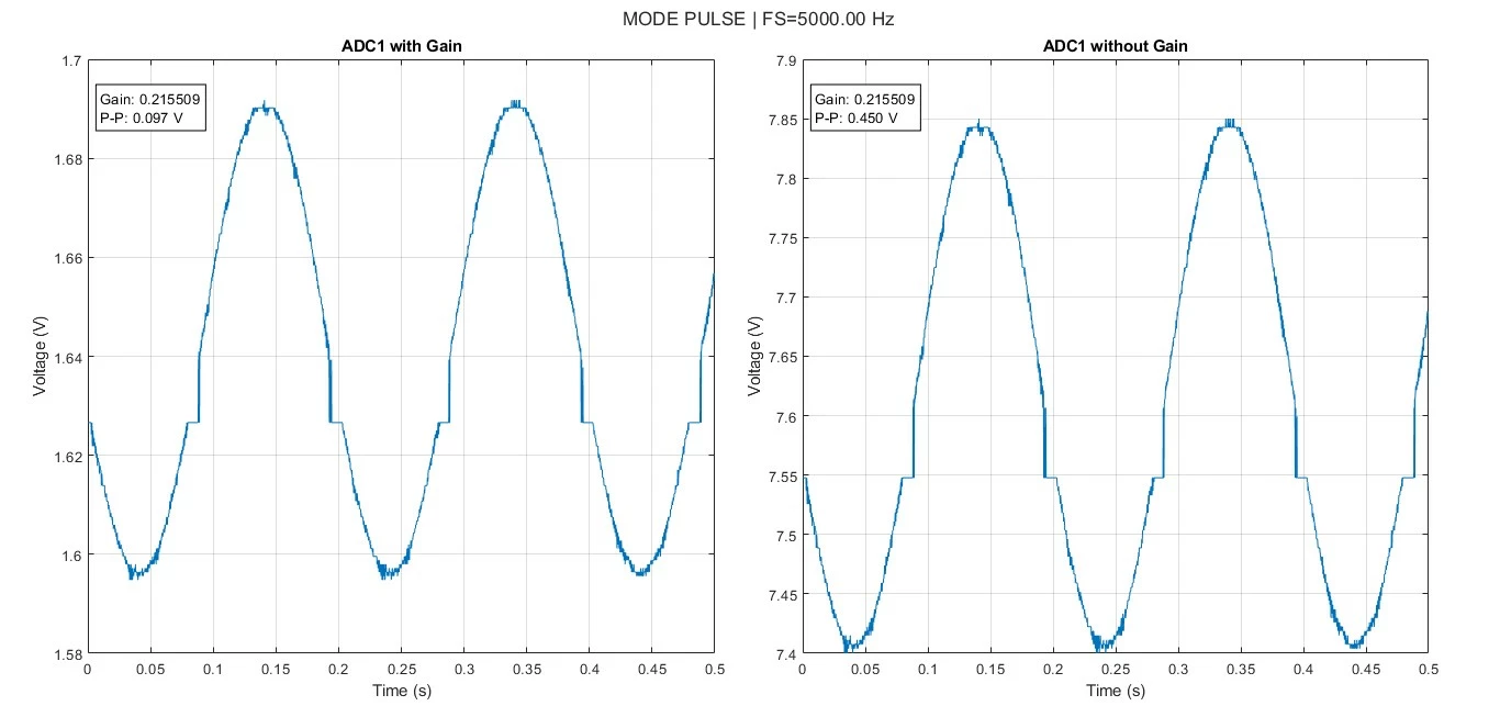

"Jumps" in ADC output of stm32G474RET6 using DMA
I am running the ADC using a timer trigger and DMA to sample a sinusoidal signal.
The captured samples are transmitted to a PC via UART.
However, as shown in the attached image, the ADC output appears to be step-like and does not capture smoothly changing values, even though the input signal is a clean sine wave.
I have checked the external reference voltage, interrupts, and the microcontroller power supply, but the issue still persist

Are you calibrating the ADC on startup? This is mandatory.
Are there appropriate decoupling caps next to the VREF+ pin?
Consider sharing the schematic if you can.

The error may be in your DMA code?
Try ADC sampling by polling first for checking analog input signal integrity.
The images show that it does correctly capture the smoothly changing values most of the time - there is just a regular "glich" at a certain point in the waveform.
Does that glitch correspond to where your DMA completes?
Or where your UART transmission occurs?
Or something else that happens regularly in your system?
As @KnarfB said, have you tried it without DMA ?
Have you tried it with steady voltages - to see if it's something to do with that particular voltage range (rather than time-related) ?
Have you checked the  actual input voltage at the STM32 pin ?
