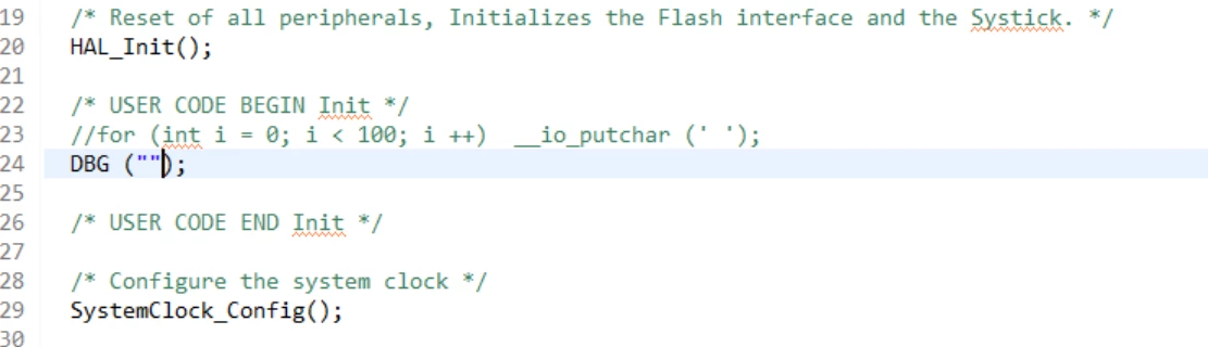

Paul.Lee
Paul.LeeAuthor
October 21, 2024
I solved this problem by
call __enable_irq after SystemClock_Config();
But, at line 123 DBG function(formatted uart out function) should be needed.
DBG function use pvPortMalloc inside. passing "" null.
If ommit this call, not not work.
Anyone know how?
