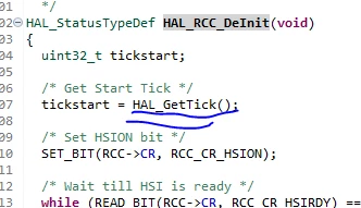

Yes, I did:
HAL_StatusTypeDef HAL_RCC_DeInit(void)
 uint32_t tickstart;
 /* Get Start Tick */
 tickstart = HAL_GetTick();
 /* Set HSION bit */
 SET_BIT(RCC->CR, RCC_CR_HSION);
 /* Wait till HSI is ready */
 while (READ_BIT(RCC->CR, RCC_CR_HSIRDY) == RESET)
 if ((HAL_GetTick() - tickstart) > HSI_TIMEOUT_VALUE)
 return HAL_TIMEOUT;
The first line "tickstart = HAL_GetTick();" jumps to fault handler

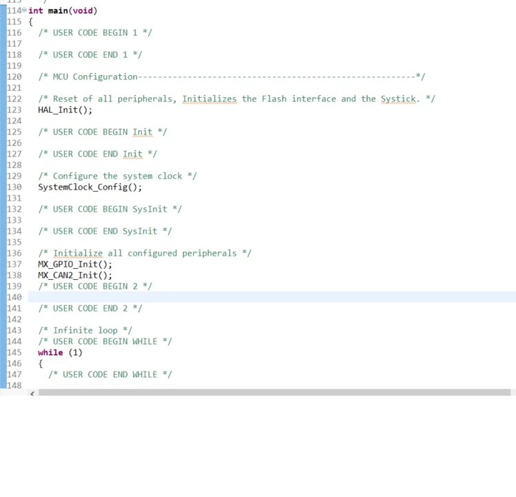

there you have the culprit, show me how youre initialicing the systick
hit me up in https://www.linkedin.com/in/javiermuñoz/

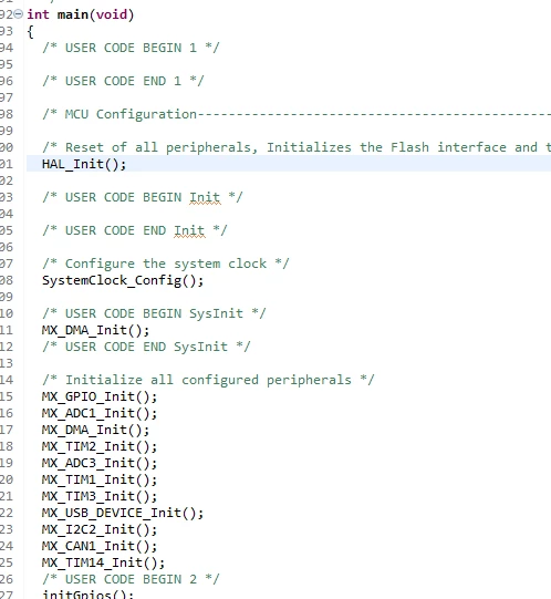

Here:

looks alright, is the systick ticking at all?
Take a look at "uwTick" variable in your live expressions while debugging
NASI
NASIAuthor
January 11, 2023
Yes the variable is ticking
