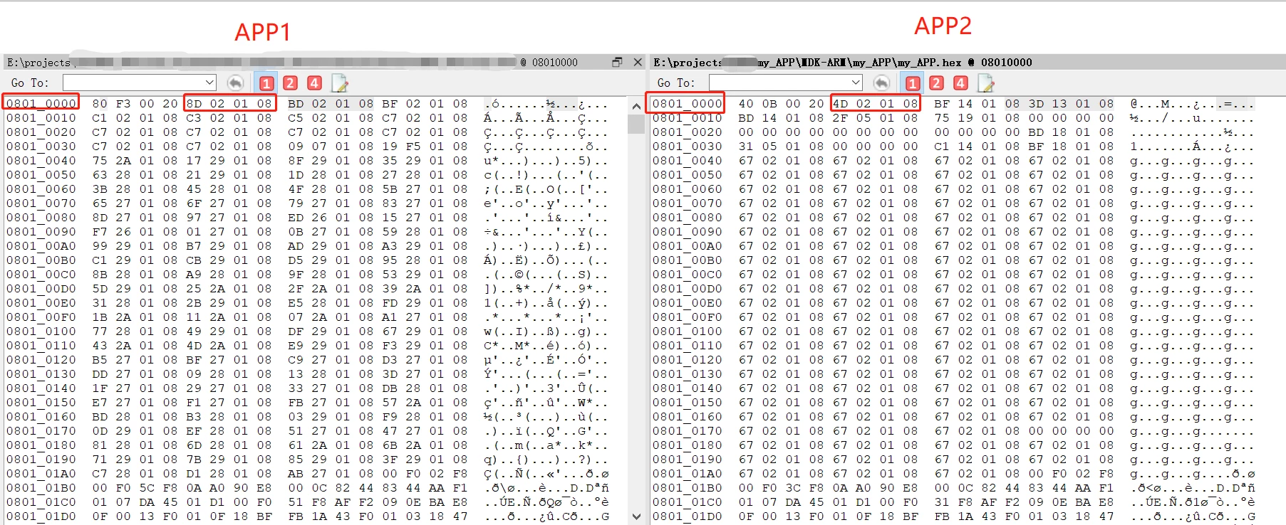

I check the bin file of "APP1" and "APP2" as below:
(We can see both the APP start addresses are 0x08010000, and I also checked the Reset_Handler start address with the map file)
Now, I want some help with why it happened, what should I try next, or how to debug this issue.

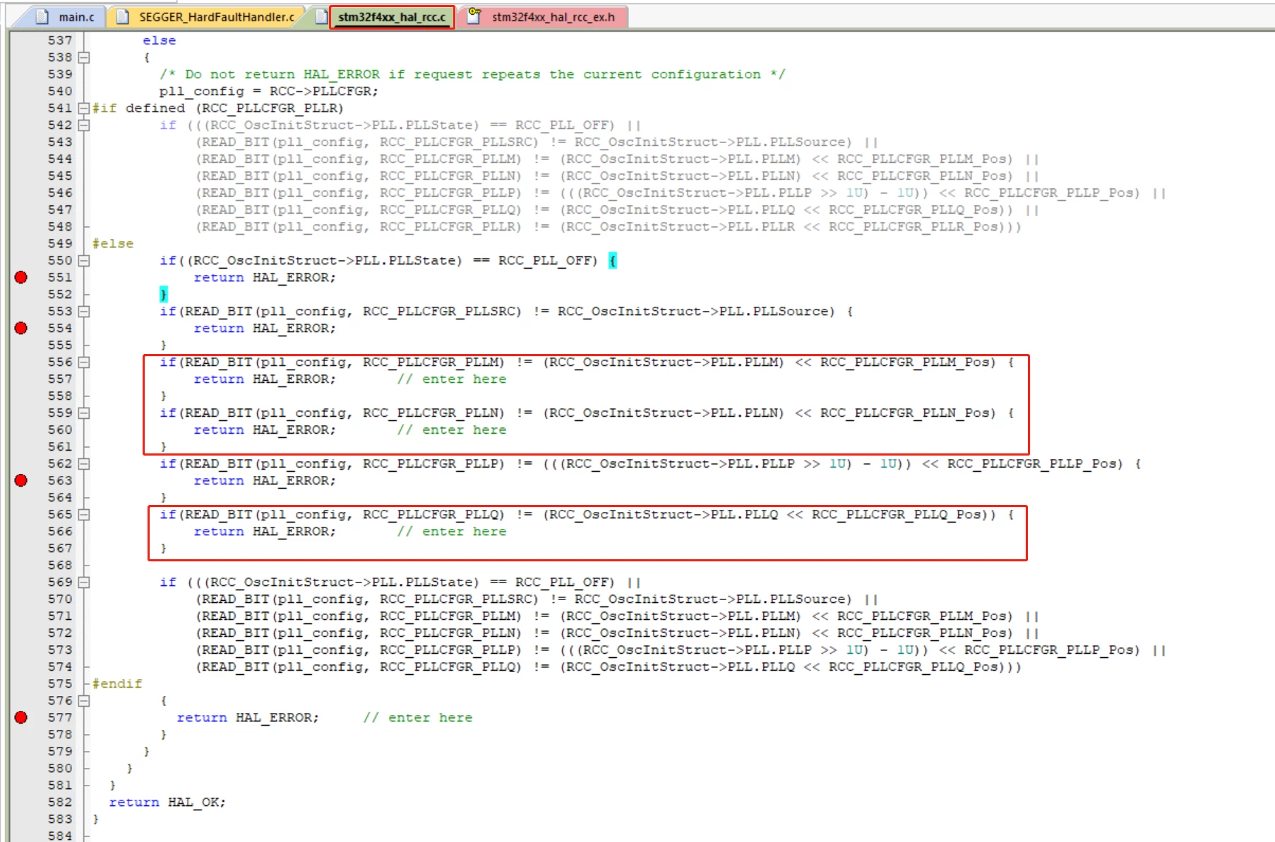

This issue is over:
The reason is easy: because the clock config in the project "BT1" is different from the project "APP2"!
But I am a little curious, we already reinitialized the clock in "APP2" which is generated by stm32CubeMx, why should the clock config remain the same between the bootloader and application?

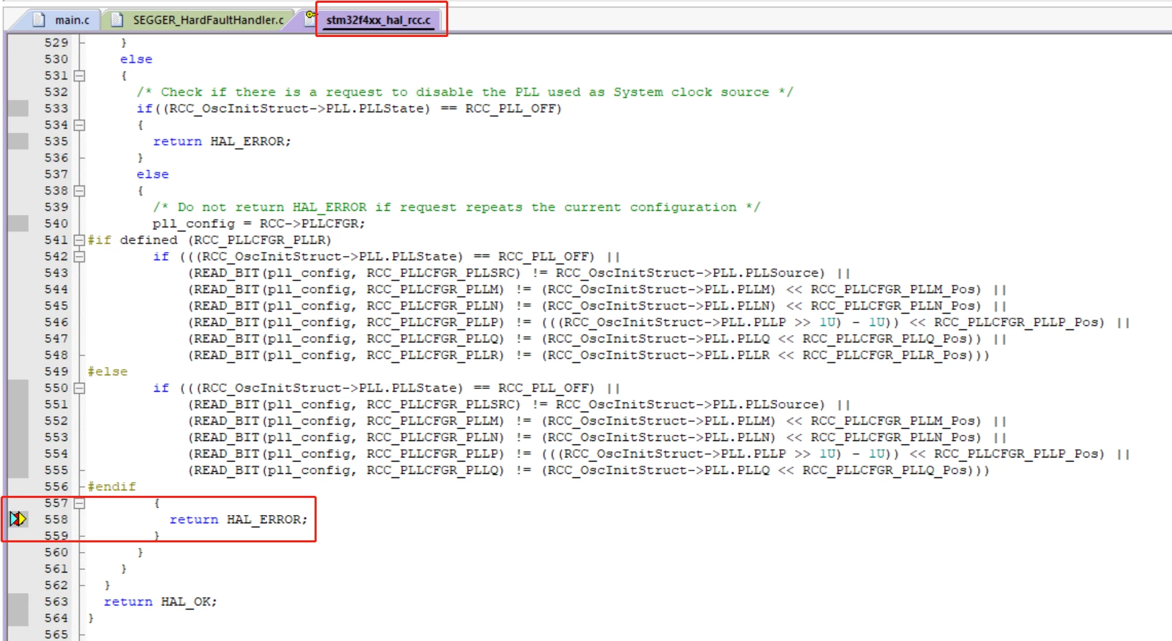

finally, I traced to here:
(the error happened at function HAL_RCC_OscConfig() in stm32f4xx_hal_rcc.c )

In following 3 "if" will return HAL_ERROR:
