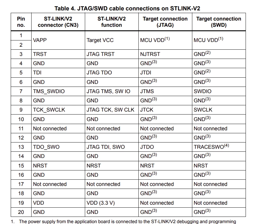

JTAG connections for STM32G474 controller
I am connecting STM32V2 debugger at following pins.
This supports SWD. I want to use JTAG pins and want to use STM32V2 debugger as a JTAG connection for debugging purpose.
can you support me how to connect or which pins to be used and what is the procedure to change from SWD to JTAG mode?

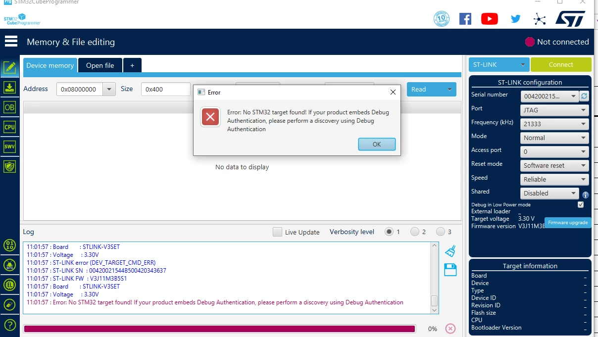

I used the pins for JTAG as below.
But i am getting below error .
Can you let me know how to solve the error and connect the JTAG?
Regards,
Nikhil
Andrew Neil
July 2, 2024
That's just the complete pinout list for the ST-Link - so doesn't really tell us anything.
Show your schematic with how you connect the ST-Link to the chip.
Can you connect over SWD ?
Why is it that you require JTAG rather than SWD?

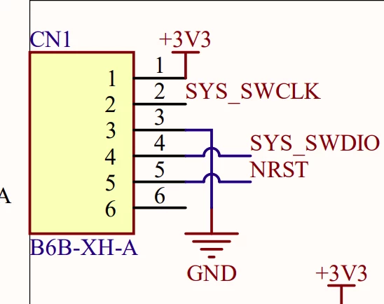

Nsg1987
Nsg1987Author
July 3, 2024
Hello @Andrew Neil
Below is the connection diagram between ST-LinkV2 and MCU.

Andrew Neil
July 3, 2024
Looks right - apart from the switch:
Are you sure you have the correct pin numbers for the MCU?
@Nsg1987 wrote:
SWD connection works fine but we have observation that when MCU is in debugging mode and MCU is generating PWM pulses for power circuit, the moment power circuit starts to draw the power, MCU comes out of the debugging and we are not able to watch the various parameters in watch window. Hence, we would like to go with JTAG
What makes you think that JTAG won't suffer the same effect?
Sounds like you have an underlying EMC issue which needs addressing ...

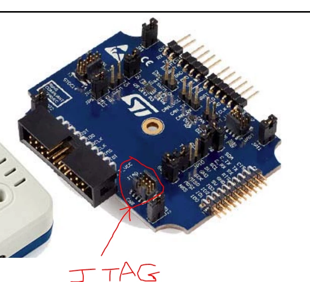

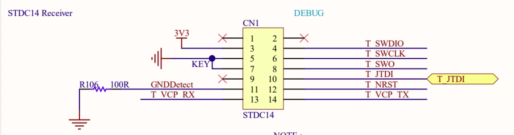

In order to avoid conflict of pins, we tried to use JTAG connector of B-G474 evaluation board. The CN1 connector of B-G474 board is connected to JTAG connector of ST-Link V3 debugger.
we took care of shorting SB28 solder bridge and to remove R89 to use CN1 as a JTAG of B-G474 board.
ST-Link V3 JTAG
To our surprise, we are still getting above error.
Here we made sure that the JTAG pins of B-G474 is not conflicting with any other.
Regards,
Nikhil
Andrew Neil
July 15, 2024
Again, you're only showing one end of the connection - both ends need to be correct for the connection to work!
Are you sure you're using the correct cable?
You still haven't said why you want JTAG when SWD works fine?
