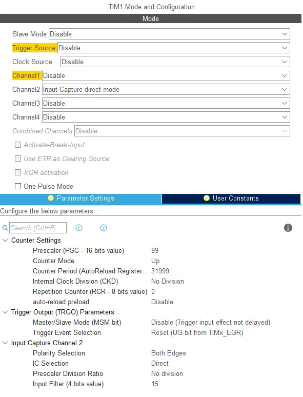

Lionel1
Lionel1Author
September 30, 2019
Hi
Well, here is my first try for the input capture part. It work almost good ! But sometimes, ICValue_High is greater than ICValue_Low. So, I suspect that the timer don't stop after the second reading. How can I configure the timer for a start at the first reading and a stop at the second reading ?
See my configuration in the picture and the code below :
int main(void)
// .... All initializations
 HAL_TIM_IC_Start_IT(&htim1, TIM_CHANNEL_2);
 while (1)
uint32_t ICValue_High = 0;
uint32_t ICValue_Low = 0;
uint32_t IC_Diff = 0;
uint16_t IC_Index = 0;
uint32_t distance_cm;
void HAL_TIM_IC_CaptureCallback(TIM_HandleTypeDef *htim)
 if (htim->Channel == HAL_TIM_ACTIVE_CHANNEL_2)
 if (IC_Index == 0)
 /* Get the 1st Input Capture value */
 ICValue_High = HAL_TIM_ReadCapturedValue(htim, TIM_CHANNEL_2);
 IC_Index = 1;
 else
 if (IC_Index == 1)
	/* Get the 2nd Input Capture value */
	ICValue_Low = HAL_TIM_ReadCapturedValue(htim, TIM_CHANNEL_2);
	/* Diff capture computation */
	IC_Diff = (ICValue_Low - ICValue_High);
	/* Distance */
	distance_cm = (IC_Diff*40)/1000;
	IC_Index = 0;

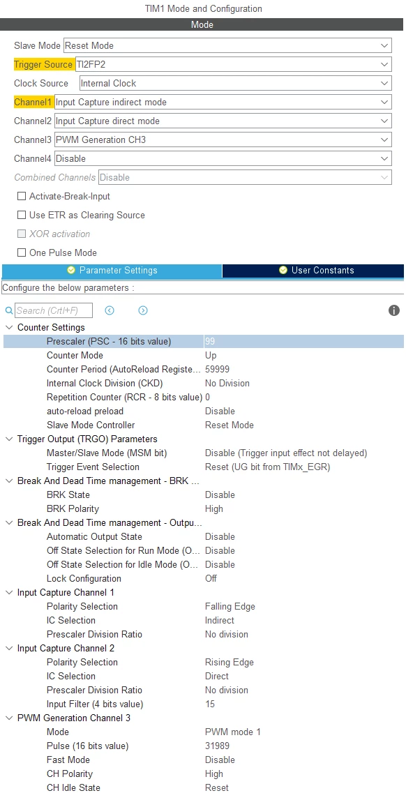

Lionel1
Lionel1Author
September 30, 2019
Hi again !
I try a new version with PWM pulse to activate the sensor and input capture for the response.
I defined a 60 ms period and a 1 us time step for more precision for the result (APB2 clock is 100 MHz).
I use CH3 for the 10 us PWM pulse (but not sure for the pulse value) = pin PA10 (trigger)
I use CH2 for the rising input capture = pin PA9 (echo)
I use CH1 for the falling input capture = pin PA9 (echo)
Problem is that I am a little confused when I must Start and Stop the different Channel !
 HAL_TIM_IC_Start_IT(&htim1, TIM_CHANNEL_1);
 HAL_TIM_PWM_Start_IT(&htim1, TIM_CHANNEL_3);
with the callback :
void HAL_TIM_PWM_PulseFinishedCallback(TIM_HandleTypeDef *htim)
The duration of the echo should be :
duration = HAL_TIM_ReadCapturedValue(htim, TIM_CHANNEL_2) - HAL_TIM_ReadCapturedValue(htim, TIM_CHANNEL_1);
My CubeMX configuration in the picture joined.
Thanks,
Lionel
