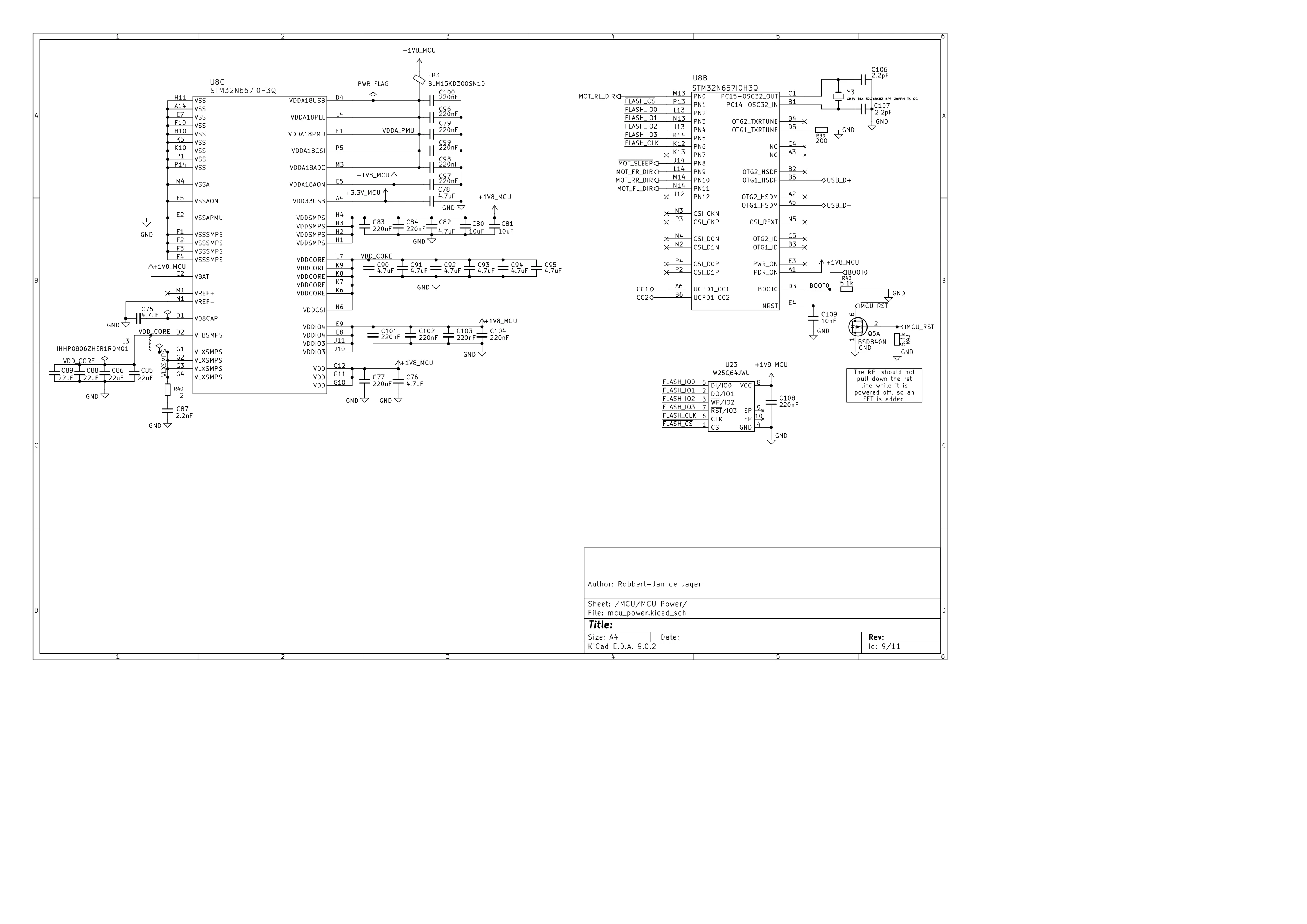

Hey All,
I hope you can help me. I'm trying to bring up my new board, which contains a STM32N657IO. Attached are the schematics. You can assume the 5V supply is working(it is after a few bodge wires).
My problem is as follows. I'm trying to connect to the STM32N6 over SWD using a JLink. It seems the SWD communication with the Debug port is successful, but the communication with the core fails. I get the following output when trying to connect to the MCU:

I already investigated the following:
  • 1.8V is present
  • the 24MHz oscillator is running
  • the 0.8V internal SMPS is running and producing 0.8V
  • the reset line is high, and the jlink toggles it low while trying to connect
  • I used an logic analyzer on the SWD lines, and I can see correct communication until the moment it tries to an R APc followed by an RDBUFF, which is responded with fault.
  • Boot0 low or high, doesn't seem to matter
  • I tried to connect via the USB ROM bootloader. The host detects an device, but the device never responds to the hosts set address request. (Only host to device communication, no reply)
  • I don't see any activity on PG10, which may container bootloader debug output
  • I tried to use STMCubeProgrammer, but It doesnt support the STM32N6 using the JLink
  • I noticed that I forgot to tie PDR_ON to 1.8V, luckily this ball is in the corner of the chip so I could solder an wire to the ball (thin wire, lots of flux, and heating the wire to melt the solder of the ball to the wire over a small distance, connection seems solid)
These are my remaining ideas:
  • Maybe the JLink doesn't support this new MCU correctly. I could buy an ST-Link v3minie
  • Something is wrong with my power rails, maybe sequence.
So, my question is. Does anyone have an idea what could be wrong?

Hi @robojan
To be able to connect using STLink or J-LINK in JTAG/SWD, the STM32N6 must be in DEV_BOOT mode.
You must apply the correct level on BOOT1 (PA6) and BOOT0)
In the schematic, BOOT0=GND, but BOOT1 is floating/unconnected. I think the MCU is in unknow state.
Refer to the AN5967: in section 10 Boot configuration

robojanAuthor
Jul 2, 2025 6:16 PM UTC
Hey Romain,
Thanks for you pointer. For some reason I had it in my head that as long as boot0 was defined, boot1 could be an don't care. (with the correct fuses). The dev-mode is still new to me.
Sadly, I did not connect this ball to an external trace. Luckily with some effort I could drill a hole through the PCB and connect boot1 to 1.8V. Now I am able to connect with the J-Link.
