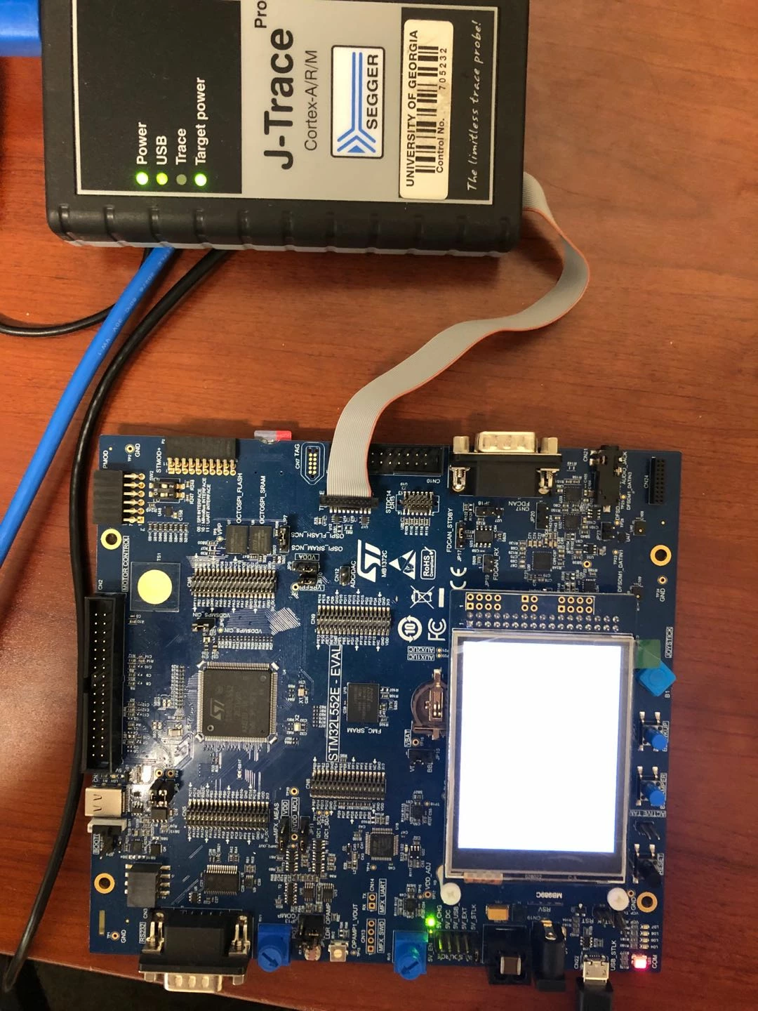

I’m learning embedded development with a J-Trace Pro and an STM32L552E-EV board. After downloading the trace demo project from the segger wiki, I try to debug it with Segger Embedded Studio and Ozone.
Here is the board information.
https://www.st.com/en/evaluation-tools/stm32l552e-ev.html
Here is the demo trace project wiki.
https://wiki.segger.com/Tracing_on_ST_STM32L552
The attach is how I connect J-Trace Pro with the board.
However, when click the debug button, the panel shows the error information:
Disabled output of control charactersJ-Link software found at:

Failed to erase sectors 0 @ address 0x08000000 (Unknown algo: Unspecified error #1)
Failed to erase sectors.
Download failed: J-Link reports an unspecified download error
Could you please help to figure out the problem?
Besides, when I try to config and use Jtrace pro with STM32CubeIDE, it also doesn't work. Could you please share a tutorial to config to use J-Trace/J-Link inside the STM32CubeIDE?

Perhaps pick an option where it doesn't try to download the code when you haven't specified a flash loader/algorithm for the STM32L5
Check that you have the solder bridges/resistors configured to permit trace. Can't use trace concurrent with SD Card.
Hopefully it doesn't need an ODD address for the PC
CubeIDE, L5, J-Trace probably a bit too specific/narrow. Find something close/general and triangulate.
