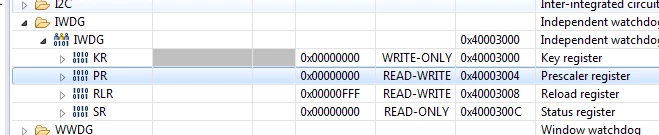

Configuring the clock at 168MHz and doing the reset as fast as possible (5,56MHz each 219ns) and with    hiwdg.Init.Reload = 0, the system continuous restarting. With
hiwdg.Init.Reload = 1 the system do a restart if I do not reset the IWDG at a frequency higer than 30kHz (each 33,3us).
Any one knows if this performance is normal?
Why the manual reference (
http://www.st.com/content/ccc/resource/technical/document/reference_manual/3d/6d/5a/66/b4/99/40/d4/DM00031020.pdf/files/DM00031020.pdf/jcr:content/translations/en.DM00031020.pdf
 ) in the page 712 sais that minimum timeout are 0,125us if it do not work?
Furthermore I have check too that the registers are right configured:
