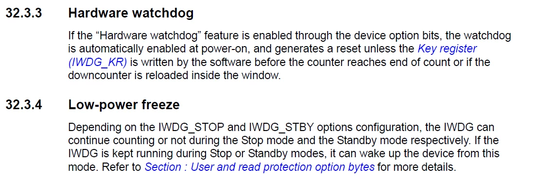

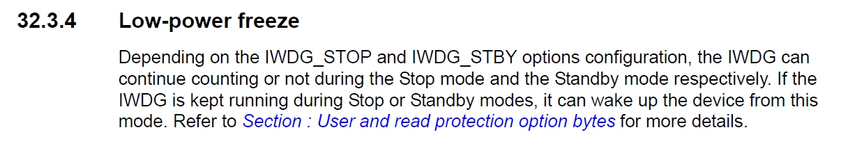

Hello.

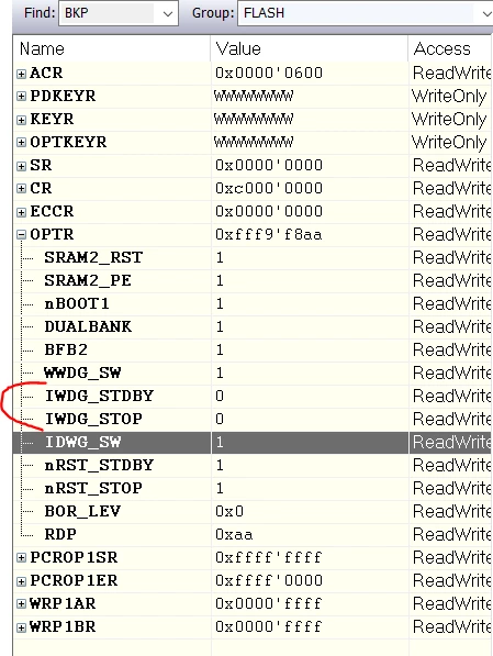

I am running STM32L412 microcontroller in low power GSM design. All works great, but I would also want to add watchdog just in case.
I am in STOP2 mode most of the time, and I am waiting for interrupts from GSM module or MEMS IRQ
I configured IWDG for 30s reset, I reload it just before sleep that takes 4 minutes (IWDG = 30s).

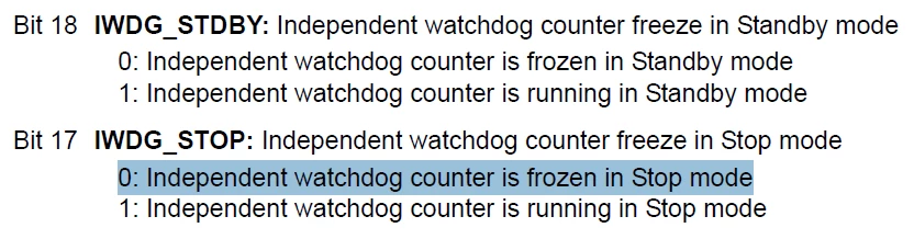

In boot I also RESET IWDG_STOP and IWDG_STBY bits based on reference manual, I also check FLASH OP register to see if bits are truly zeros and they are.
0693W00000WHW63QAH.png0693W00000WHW68QAH.png0693W00000WHW6DQAX.pngBUT I still been RESETED in STOP2 mode, while it should NOT HAPPEN based on my limited understanding.
Any ideas what I am doing wrong ?

Could you be more specific whats wrong ? OPTR resgisters are protected at boot and cleared, be me afterwards, but IWDG still resets MCU in STOP2 mode.
What do I am missing or do not understand, clearing FLASH_OPTR_IWDG_STOP should stop IWDG running while in STOP2 mode, and prevent it from reset, right ?

Looks like I get it working. Problem was I was not clearing IWDG_SW (to enable Hardware independent watchdog) bit.
And it's very hard to understand why I need to do this, since reference manual does not give simple answer.
And yes, Piranha, your code did that, but I was not clear why. RM is not that clear I needed to do it in low power freze...

No, EEPROM emulation has nothing to do with option bytes. And no, IWDG_SW has nothing to do with stopping IWDG in low-power modes.
The RM0394 Rev 4 section "3.4.2 Option bytes programming" explains all of this very clearly. But you don't understand it because you haven't done the RTFM. When you will read it, you will also understand what and why my code does.

So can you explain why my code runs now the way I expected ?
update:
Ok, so I looks like I am missing OPTSTRT and OBL_LAUNCH procedure, and IWDG just gets updated registers after reset.
I will add this to my code. I gess I so hang up on seeing that registers are updated, just did not understand/read that they need to be launched to take effect.
