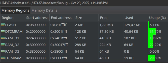

Using ITCM on H733 here, for vector table and some functions.
in linker file *.ld :
MEMORY
ITCMRAMVEC (xrw) : ORIGIN = 0x00000000, LENGTH = 1K /* instruction RAM - vector table */
ITCMRAM (xrw) : ORIGIN = 0x00000400, LENGTH = 31K /* instruction RAM */

I use almost all memories on H743 :
>Somebody sees what I’m doing wrong?
D tcmram is for data - as you tried with success.
I tcmram is for code only ! use for data is nonsense , would be slower than normal ram, if working at all; (access restricted, read rm . or ask Gemini ...)
Just set in linker script, what you want to be in itcmram  area.
Oct 13, 2026 5:32 AM UTC
Yes, indeed.
In the link script only my “.scode” goes into ITCM (“.sdata” and “.sbss” to DTCM respectively).
That is, I have not put any data within ITCM, only tried to see what the debugger finds there.
