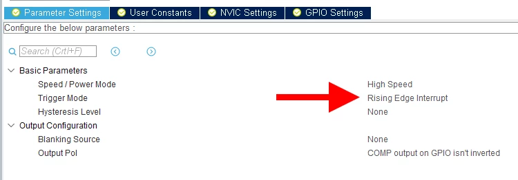

    0693W000000UYDOQA4.pngSo far I have determined that bad things start to happen with interrupt enabled, irrelevant if they are really used:
    Rising edge event does not cause this problem.
     I presume something went wrong in CubeMX code generation with EXTI lines.....will continue my research....
    Achau.13
    Visitor II
    March 24, 2020
    This is how i managed to fix the issue ​https://community.st.com/s/question/0D50X00009XkhHNSAZ/cubemx-422-stm32f37xx-lib-19-comp-irq-bug
