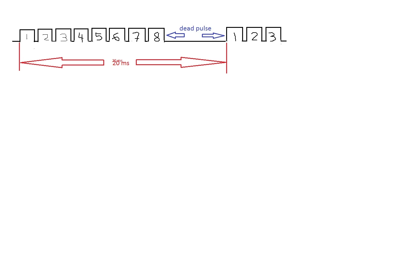

    If i still talk about timers, i was wondering of a better solution to synchronize my pulse indexes.
    I have put a picture bellow.
    My ppm signal is composed of 8 pulses with ranges from (500 to 2000uS) and pause between 8 pulses of aprox 300uS.
    The ppm pulse frames are sent with a rate of 50hz between each frame.
    and i thinked to declare a array like uint32_t pchan[8], and to asign to each pchan the number of the pulse index, example pchan[0] = pulse1, pchan[1]=pulse2 and so on...
    I was thinking of measure the time between the last falling edge of the current frame and the first rising edge of the next frame, and if the period is greater than a maximum pulse width (2000us), then consider for the next pulse, index should be 0.
    I am asking if there is a best solution for achiveing this
    void TIM2_IRQHandler(void)
    if(TIM_GetITStatus(TIM2, TIM_IT_CC1) == 1)// If compare capture has occured
    TIM_ClearITPendingBit(TIM2, TIM_IT_CC1);
    capture1 = TIM_GetCapture1(TIM2); // Get timer counts for Period
    capture1 = capture1 -capture2 ; // get the Toff value between pulses
    if (capture1 >2000){ uu=7;} //if we detect the ''dead pulse'' reset pulse index
    if (uu>7) { uu=0;} // if the index reached maximum allowed index, reset it !
    if(TIM_GetITStatus(TIM2, TIM_IT_CC2) == 1) {// If compare capture has occured
    TIM_ClearITPendingBit(TIM2, TIM_IT_CC2);
    capture2 = TIM_GetCapture2(TIM2);
    pchan[uu]=capture2 ;
    Tesla DeLorean
    Guru
    July 5, 2015
    Posted on July 05, 2015 at 15:03
    I'm familiar with PPM signals, and it's a topic that's been covered here before, several times.
    You'd want to save the delta values into an array, along with code to confirm an ~20ms repetition rate, and to resynchronize the table. With thought DMA could be used to decimate the interrupt loading.
    Your code appears missing an uu++
    Bogdan
    BogdanAuthor
    Senior
    July 5, 2015
    Posted on July 05, 2015 at 16:37
    You're right, i forgot when i pasted the code .
    I not used any delta values, because the values are very true already from the capture register.
    For example my signal is 1050us on, and 300us off
    And the values coming out from capture1 are ton+toff ( 1350 us)
    and on capture2 i have 300us.
    Just did a simple substraction capture1=capture1-capture2
    Does the dma automaticly fills the array with values from the timer capture register?
    Do you have a example code of using ppm and DMA for timer input capture?
