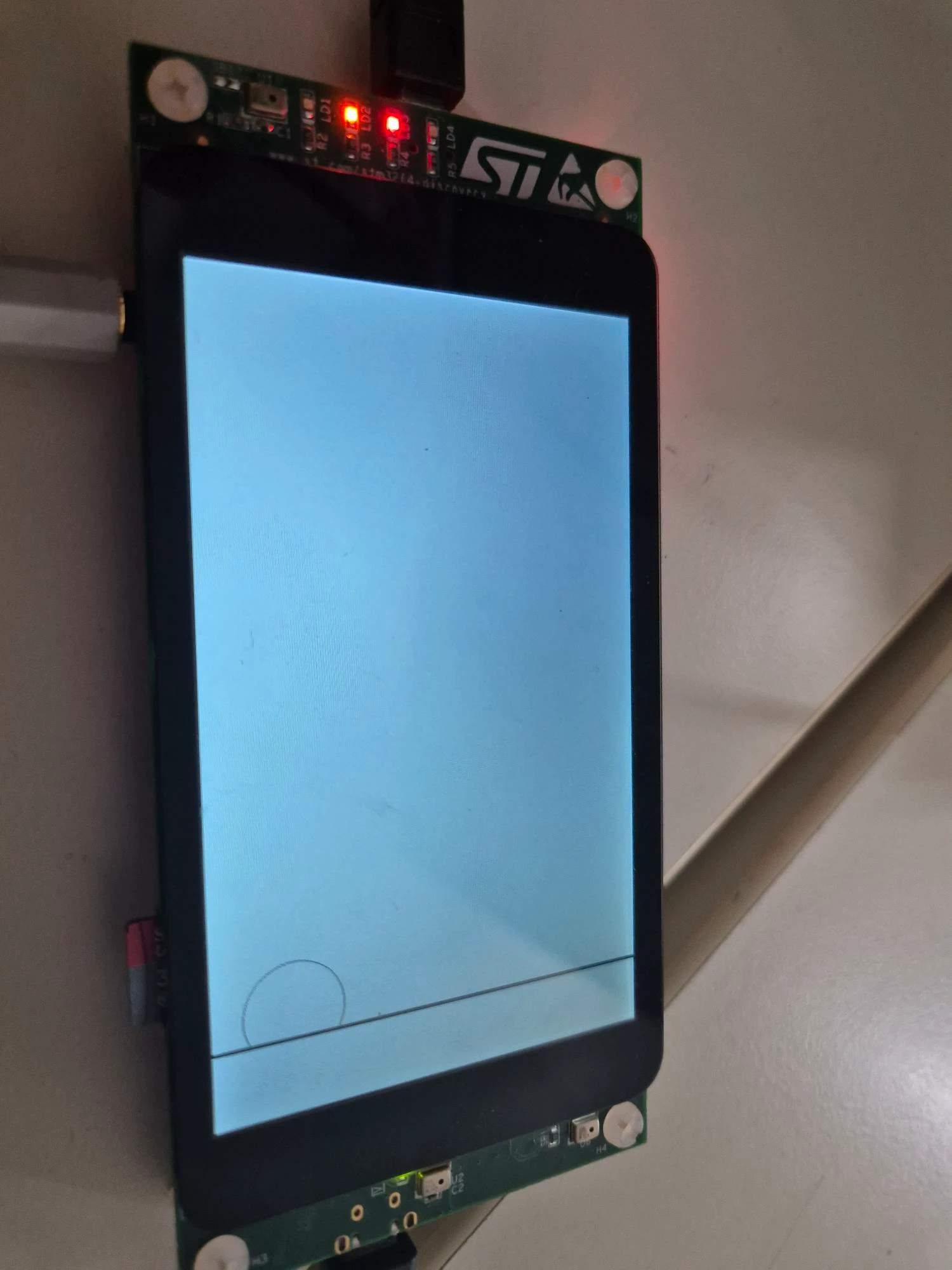

Hi everyone,
I'm encountering a problem with my STM32 project where I need to use both LTDC for display and audio playback (via FATFS). The issue seems to stem from a conflict in clock configurations.
My setup:
    MCU = STM32F469i-Disco
The problem
When I configure the clock for LTDC like this:
LTDC clock configuration (stm32469i_discovery_lcd.c line 342):
PeriphClkInitStruct.PeriphClockSelection = RCC_PERIPHCLK_LTDC;
PeriphClkInitStruct.PLLSAI.PLLSAIN = 384;
PeriphClkInitStruct.PLLSAI.PLLSAIR = 7;
PeriphClkInitStruct.PLLSAIDivR = RCC_PLLSAIDIVR_2;
HAL_RCCEx_PeriphCLKConfig(&PeriphClkInitStruct);
The display works perfectly, but the audio playback through FATFS fails (specifically in Audioplayer.c at line 42).
However, when I comment out the LTDC clock configuration:
// PeriphClkInitStruct.PeriphClockSelection = RCC_PERIPHCLK_LTDC;
The audio playback works again, but the display shows an artifact—a black line appears on the screen (as shown in the attached image).
LTDC Timing Configuration:
hltdc_eval.Init.HorizontalSync = (HSA - 1);
hltdc_eval.Init.AccumulatedHBP = (HSA + HBP - 1);
hltdc_eval.Init.AccumulatedActiveW = (lcd_x_size + HSA + HBP - 1);
hltdc_eval.Init.TotalWidth = (lcd_x_size + HSA + HBP + HFP - 1);
Initialize the LCD pixel width and pixel height:
hltdc_eval.LayerCfg->ImageWidth = lcd_x_size;
hltdc_eval.LayerCfg->ImageHeight = lcd_y_size;
My question:
How can I resolve this conflict so that both the LTDC display and audio playback work simultaneously without any artifacts or errors? Is there something wrong with my clock configuration, or is there a better way to manage the clocks for these peripherals?
Any insights or suggestions would be greatly appreciated!
Thanks in advance for your help.

August 9, 2024
@Andrew Neil wrote:
What is that line? What, exactly, goes wrong there?
I forgot to put my code in there im sorry for that. its happening on line 19 here or when you have downloaded the file on line you will find it in audioplayer.c on line 42 on the f_lseek function it gives me the fatfs error "FR_DISK_ERR".

And here you can see what happens.

Andrew Neil
August 9, 2024
So step into that function to see exactly what fails, and where.
Again, have you looked at the interface lines with a logic analyser or scope to see what's happening?
