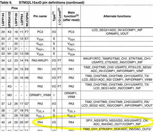

Posted on October 16, 2014 at 13:10
Hallo Clive,
By setting the
GPIO_InitStructure.GPIO_Mode of the NSS to GPIO_Mode_Out
and not as AF Pin, I could get the Chip Select signal on scope and then I could also see SCLK , MOSI. Thanks for your feedback.
However according to datasheet, SP1_NSS is available as Alternate function on the PA4. See below. Or is my understanding wrong about the table below:
Regards.
Tesla DeLorean
Guru
October 16, 2014
Posted on October 16, 2014 at 19:22
By setting the GPIO_InitStructure.GPIO_Mode of the NSS to GPIO_Mode_Out and not as AF Pin, I could get the Chip Select signal on scope and then I could also see SCLK , MOSI. Thanks for your feedback.
The misunderstanding probably relates to the SPI peripherals configuration with respect to SPI_InitStructure.SPI_NSS, ie hard, soft, mushy, etc. and what than means related to GPIO/AF
