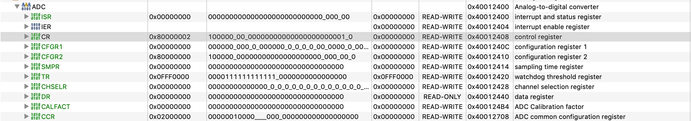

I'm working with an STM32L031F4 and I'm trying to calibrate the ADC to no avail. I'm wondering what it is that I'm missing here.
With the code snippet below, I never get out of the while loop and the CALFACT stays at 0 (if I understand correctly, CALFACT should be updated with the calibration results upon completion).
	RCC->APB2ENR |= RCC_APB2ENR_ADCEN;
	ADC->CCR |=	 ADC_CCR_LFMEN;	//set Low Frequency bit since I'm running <3.5M
	ADC1->CFGR2 |= (1 << 31); //set up clock for a /4 prescaler
	ADC1->CR |= ADC_CR_ADDIS; //ensure that ADC is off
	ADC1->CR |= ADC_CR_ADCAL; //start calibration
	while ((ADC1->ISR & ADC_ISR_EOCAL) == 0){}
	ADC1->ISR |= ADC_ISR_EOCAL;
The ADC clock is enabled prior to attempting to calibrate...Clock is the MSI at 2.09M with a /4 prescaler set by CFGR2..

Read back and check/post the ADC register's content.

0690X00000AQSi8QAH.pngThanks for the reply. I set bit 31 of the CR register (in line 4 of the code snippet above) but it just seems to stay in that state until I reset.

waclawek.janBest answer
Sep 3, 2019 7:31 PM UTC
Don't set ADDIS unless ADEN was set previously.
In other words, remove this line:
and try again.

Thank you JW. The calibration is working now...thanks for taking the time to offer some great advice!
