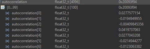

Issues using CMSIS Inverse FFT on STM32
Hey everyone. I am working on a project where I am attempting to detect a frequency of a signal using autocorrelation. I am doing this through applying FFTs and IFFTs. Basically, I have been running into some issues trying to get the correct functionality using the CMSIS dsp library and I am really struggling to figure out what is wrong and how to correct it. To provide proof of concept, I first implemented the algorithm in python like so:

And this produces the exact same result for autocorrelation as python using the FFTW dsp functions (although I had to do more conditioning/normalizing of the data compared to python). I should note that for testing I have just been using a pure sinusoid at 82 Hz to verify functionality (python works on real audio data I confirmed).
Now that's all great, but I can not seem to get the same functionality as this C code when working on the STM32 with CMSIS and I feel like I've tried everything, so I am not certian that the ifft/fft functions in CMSIS are exactly the same as FFTW or python. Here is my (not working attempt):

I tried to implement sort of what FFTW is doing, but I am not sure if that is right. But regardless, what I should get for the autocorrelation is
Autocorrelation:
767.814944
761.705596
743.474793
713.412709
671.997833
I instead get very off numbers:
I am very stuck on this, so if anyone has any sort of insight as to why the cmsis library is not producing similar results I would appreciate. I am thinking I might have to do more conditioning to the input to the ifft due to some differences, but what that is I am not sure. I pretty much only have a basic understanding of how these functions work.
Thanks.
