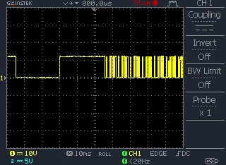

I am using an STM32F042 controller. I have to send a wake-up pattern followed immediately by 5 bytes (@10400 baud) from my device.
Wakeup pattern: 25msec LOW followed by 25msec HIGH
5 byte sequence: 0xC1, 0x11, 0xF1, 0x81, 0x44
I tried the following:
1) I configured the GPIOA, Pin 10, created a delay function and sent the Wakeup pattern. However, I am facing difficulties reconfiguring the GPIO into the USART Mode on the fly and then transmitting the 5-byte sequence.
GPIO_ResetBits(GPIOA, GPIO_Pin_10);
delay_nMSEC(25);
GPIO_SetBits(GPIOA, GPIO_Pin_10);
delay_nMSEC(25);
usart1_init(10400);
USART_SendData(USART1, 0xC1);
while(((USART1->ISR & USART_ISR_TXE) && (USART1->ISR & USART_ISR_TC)) == 0){}

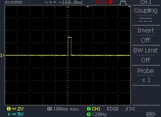

The above code does not work. I get the wakeup pattern correctly and then a single pulse of roughly 5msec after that. But no 0xC1. However, if I put the
in a while(1) loop, I get data transmission correctly. However, I need to transmit it only once.

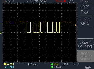

? -  Thank You for your responses. My issue was that my DSO was not capturing the bytes when it was the 250ms or higher scale. When I enabled edge-triggering on my DSO at 1ms scale, the data was captured perfectly. So the original code I gave out worked.

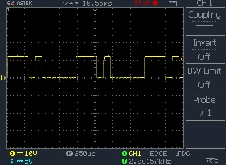

Abhishek Deouskar
Jul 3, 2018 11:42 AM UTC
Posted on July 03, 2018 at 11:42
Waclawek.Jan

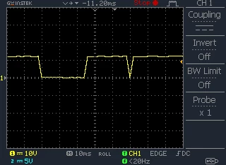

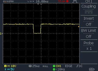

I tried the following piece of code:
timer16_config()
usart1_init(10400)
GPIOA-&gtMODER &= ~(GPIO_MODER_MODER0 << (0x0A * 2))          //Clear previous config of MODER
GPIOA-&gtMODER |= (((uint32_t)0x01) << (0x0A * 2))          //Set MODER register to OUT mode
//Wakeup Pattern
delay_nMSEC(25)
delay_nMSEC(25)
GPIOA-&gtMODER |= (((uint32_t)0x02) << (0x0A * 2))          //Set MODER register to AF mode
USART1-&gtCR1 |= USART_CR1_UE //Enable USART1
while(((USART1-&gtISR & USART_ISR_TXE) && (USART1-&gtISR & USART_ISR_TC)) == 0){}
The above is the response I got on DSO.
If say, I repeat the SendData command to the code,
I end up with this:
If I add the USART_SendData command to a while(1) loop, I eventually get my sequence, but that is after at least 100msecs
Eventually, after some time has passed:
Instead of the custom Hardware I have been using, I also tried a translated version of the code on my STM32F3 Discovery. I get the same response.
waclawek.jan
Jul 3, 2018 1:25 PM UTC
Posted on July 03, 2018 at 13:25
and

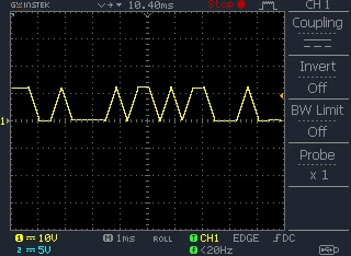

are clearly taken at different IO setting (or very different scope setting/external circuitry), given the edges/slope.
It's hard to discuss a moving target.

Abhishek Deouskar
Abhishek DeouskarAuthorBest answer
Jul 9, 2018 12:48 PM UTC
Posted on July 09, 2018 at 14:48
Waclawek.Jan
? and
Turvey.Clive.002
waclawek.jan
Jul 9, 2018 5:38 PM UTC
Posted on July 09, 2018 at 17:38
Ah, that explains it.
Thanks for coming back with the result.
Can you please tag your last post as 'Correct' so that that it can be seen that issue was resolved.
