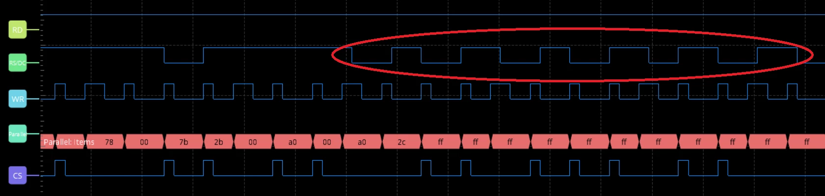

The expected result is that 12 white pixels should be lit. However, I don't see anything. If I change the pointer to point to a uint_8t, the code works except that only 3 pixels are lit since the data sent is truncated (as expected). Why doesn't the pointer to a 32-bit value work? I thought it could be something to do with timing, so I tried changing the FMC timings to the maximum, but the result was the same.

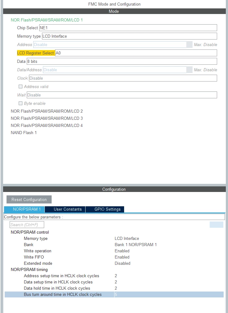

Here's my FMC settings:

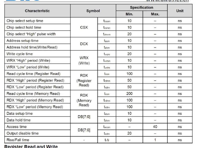

The screen is a DWO DO026QR01, if that's important. Unfortunately there's little information on the screen or the controller it uses (supposedly a S6E63F6 - I think this might be a typo since I found nothing about it. I could find info about the S6E63D6, but I don't think it supports 24-bit color so I doubt that's it). The datasheet also doesn't provide any timing information, but the company sells a module with the same screen that provides this timing info:

Ok, I think I've figured out the problem. The address bus is getting incremented, which makes sense since it's writing 32 bits to an 8-bit bus. However, I don't want this as A0 is used by the screen to determine if the data received is a command or if it's data.
Is there any way to perform the transfer without this happening?
Thanks!

Ok, I think I solved the problem. You can set the LCD register select in the FMC config to something other than A0. Setting it high enough such that the bit doesn't change when the address is incremented solved it!
