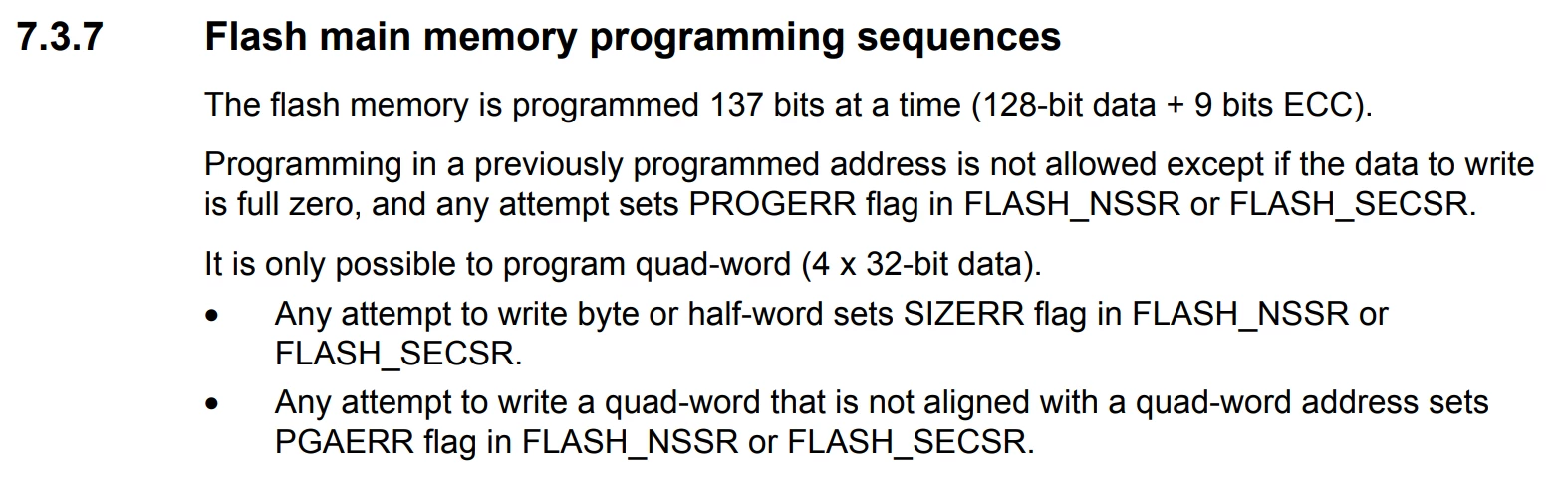

I've been troubleshooting an issue with writing to address using system Bootloader on the STM32U5A9J-DK. According to AN3155 Application Note, the data to be written during the 'Write to Memory Command' should be a multiple of 4 bytes. However, during debugging I noticed for the above mentioned device, the data must be a multiple of 16 bytes to be successfully written.
This has raised the question: Is there a way to write to the addresses which are multiple of four?

Flash on the STM32U5 must be programmed 128-bits at a time, per the reference manual. This is because it contains ECC bits.
You can write these in 4x32 bit operations.
