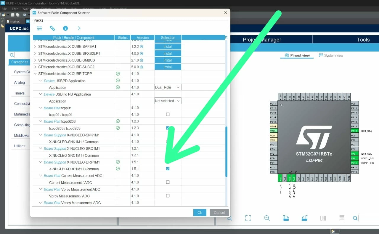

For testing purposes, we are using the X-NUCLEO-DRP1M1 expansion board and following the steps from this [video tutorial](https://www.youtube.com/watch?v=mJ4VX_2B6wE), which uses the STM32G071RBT.
However, we have encountered two main issues:

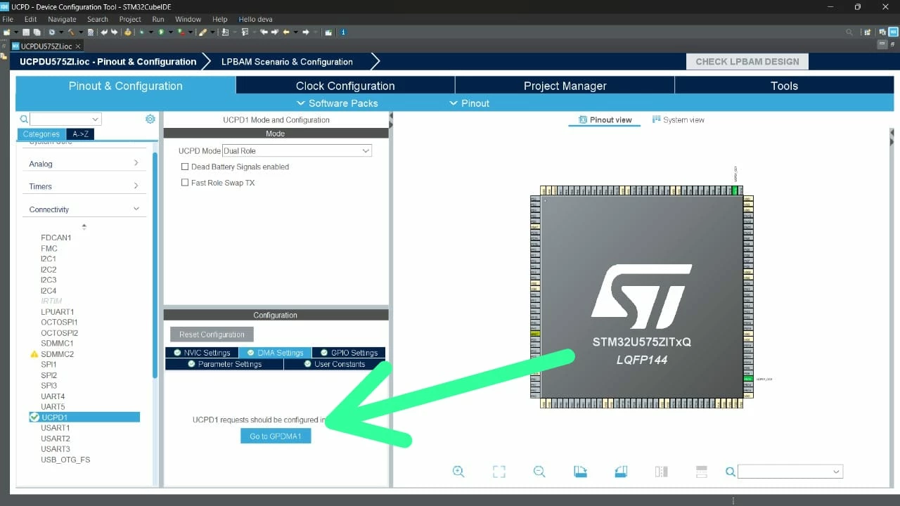

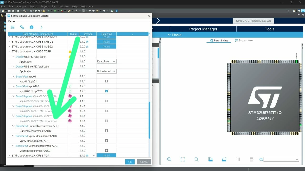

1. *X-NUCLEO-DRP1M1 options not appearing in STM32CubeMX for STM32U575ZI:*
We are unable to enable the X-NUCLEO-DRP1M1 options in STM32CubeMX for STM32U575ZI, as shown in the video tutorial (see attached picture).

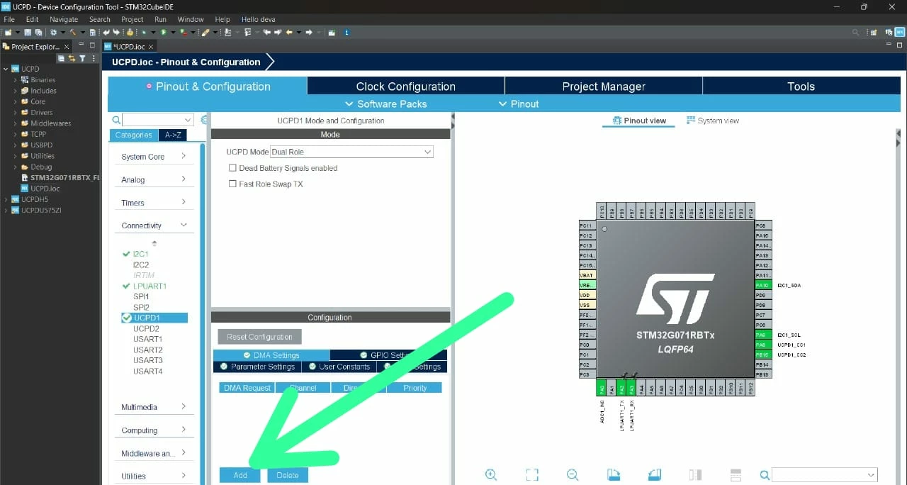

2. *DMA configuration not available for STM32U575ZI:*
While the DMA options are available and configurable when using STM32G071RBT, they do not appear for STM32U575ZI. We are unable to enable DMA options for Nucleo board STM32U575ZI, as shown in the picture.
NOTE- same we tried with custom PCB with STM32U575I-EV we are getting same result.

  1. X-NUCLEO-DRP, SNK, and SRC expansion boards are only visible in STM32CubeMX with some Nucleo 64 boards embedding UCPD peripheral.

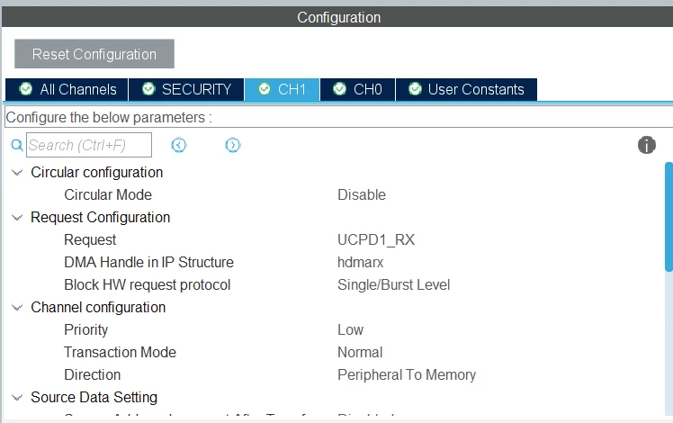

  2. For DMA configuration, you need to set up the DMA channels to handle UCPD data transfer requests for TX and RX lines.
