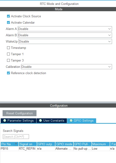

AScha.3
April 25, 2023
i set refclk in Cube->
_legacyfs_online_stmicro_images_0693W00000bilqFQAQ.pngthen cube gen ->
 /** Enable the reference Clock input
 if (HAL_RTCEx_SetRefClock(&hrtc) != HAL_OK)
 Error_Handler();
 /* USER CODE BEGIN RTC_Init 2 */
-> and no GPIO_PIN_15 init in main ... !

I don't use Cube, so I'm not sure how the code generation works, but the GPIO init is probably somewhere. Still, as waclawek.jan said, the GPIO mode I had was INPUT while your screenshot shows it in Alternate, so I'm redoing the test with it in GPIO_MODE_AF_PP. (I think we'd tried this config before, but better to be sure)
right - found it in HAL_RTC_MspInit( ) :
__HAL_RCC_GPIOB_CLK_ENABLE();
 /**RTC GPIO Configuration
 PB15 ------> RTC_REFIN
 GPIO_InitStruct.Pin = GPIO_PIN_15;
 GPIO_InitStruct.Alternate = GPIO_AF0_RTC_50Hz;
 HAL_GPIO_Init(GPIOB, &GPIO_InitStruct);
 /* USER CODE BEGIN RTC_MspInit 1 */
 -- this you didnt - right ? >GPIO_InitStruct.Alternate = GPIO_AF0_RTC_50Hz;
