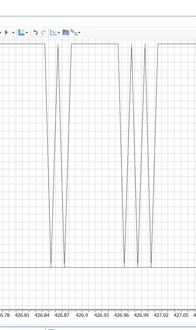

I’m working with an STM32 G0 microcontroller and encountering an issue with reading data from two sensors. One of the sensors provides consistent and accurate readings, however, the second sensor shows intermittent spikes to zero in the readings. These spikes occur periodically and affect the integrity of the data.
I’ve checked both hardware and software configurations, but haven’t found any obvious issues. Has anyone experienced a similar problem or have any idea what might be causing these zero spikes in the sensor data reading?
I know I’m not showing any information about my configuration but if anywho thinks could help me i share as much as i have
I left the signal reading of the adc that goes wrong
I appreciate any suggestions or advice to resolve this issue! Thank you in advance!

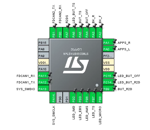

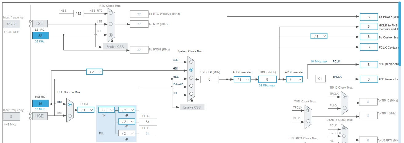

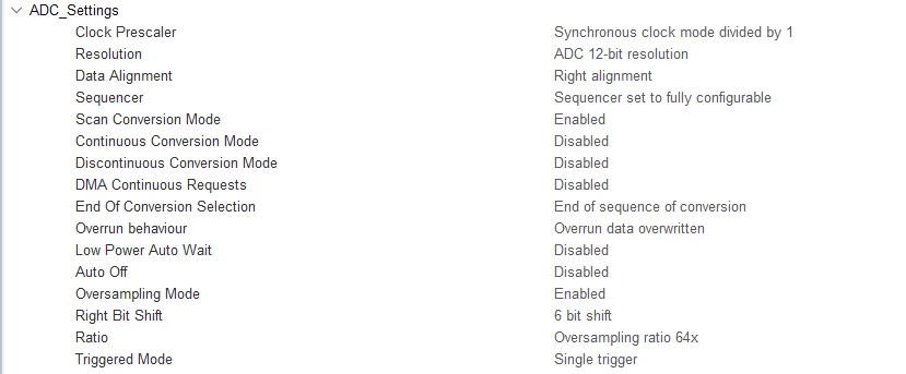

The more detailed problem is as follows : I need to reed two pressure sensor. For one the readings are fine, for the other one, every 6.5 secs the pattern shown in the picture of the original post appears, because of that some calculations done with that data acts really weird due the sudden change. Hear I attach my configuration:

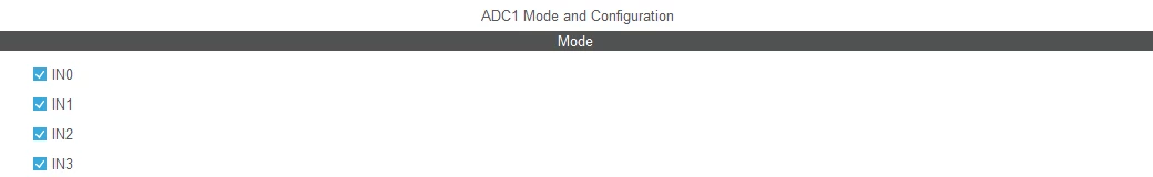

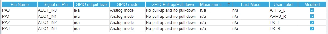

This is how I set up my periferics, where the following are used for ADC conversion
The problem ocurrs with BK_R, while BK_F works fine.

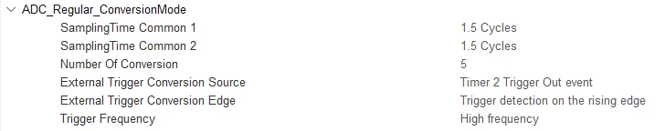

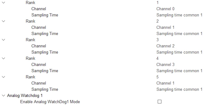

ADC configuration is:

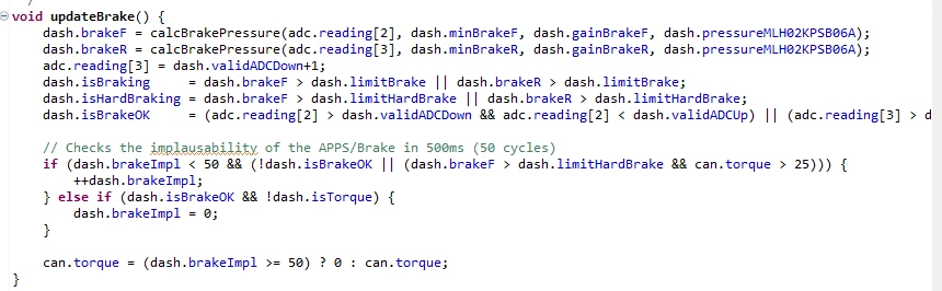

To read the data it is used this:

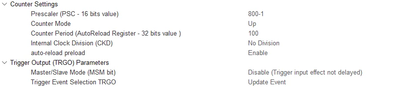

I also got a tim2 setup, I strongly believe that it is really difficult for it to cause some interference. But due to the periodic behaviour of the issue, maybe are related.

Is the problem with the channel going into adc.reading[3]?
That's the one to which you are assinging a value, so what if that's the reason for your problem. Try not to process the data at all and just observe them - still zeros?
