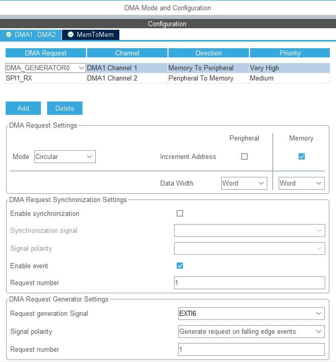

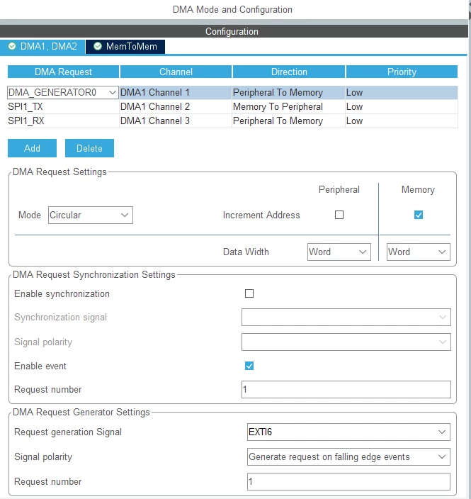

  • DMA1 Channel 1 is configured as DMA_GENERATOR0 to handle the DRDY falling edge, which triggers a DMA request. This request sets the Chip Select (CS) low by writing to the GPIOX_BRR register and also generates an event.

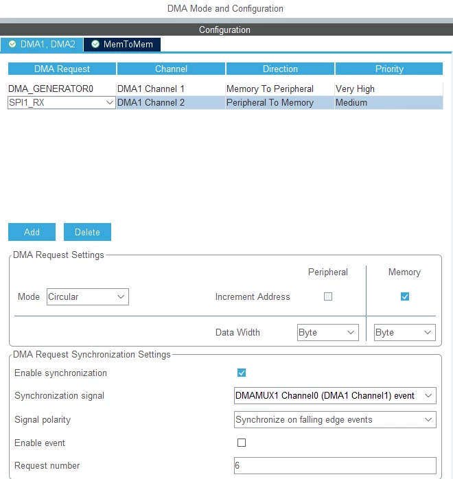

  • DMA1 Channel 2 is assigned to SPI1_RX, synchronized with DMAMUX1 Channel 0  event (linked to DMA1 Channel 1) to trigger the SPI1 receive operation, capturing 6 bytes of ADC data.

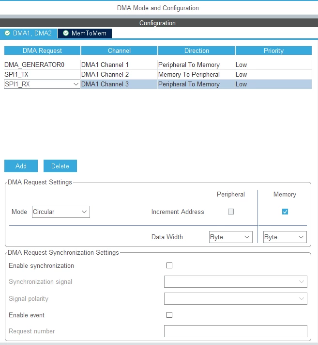

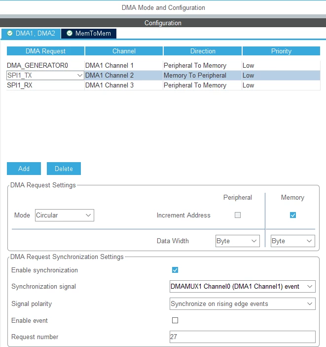

I resolved the issue by configuring SPI1 in full-duplex mode and synchronizing only SPI1_TX with DMAMUX CHANNEL0 Event. SPI1_RX was set to circular mode, allowing me to read all ADC channel data (27 bytes) every 125 µs (8 ksps) as per the setup below.
