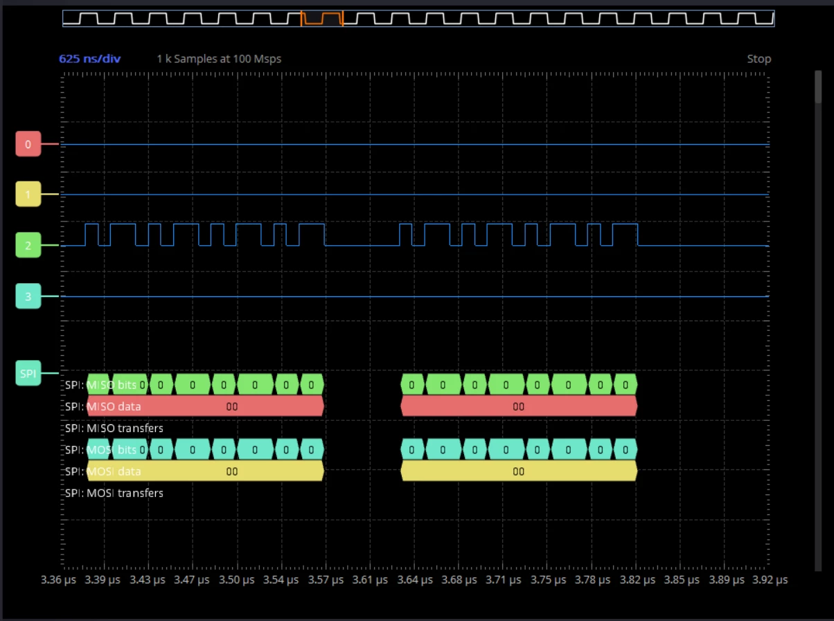

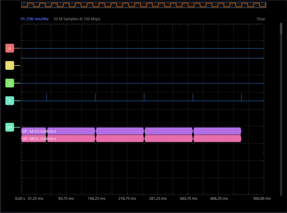

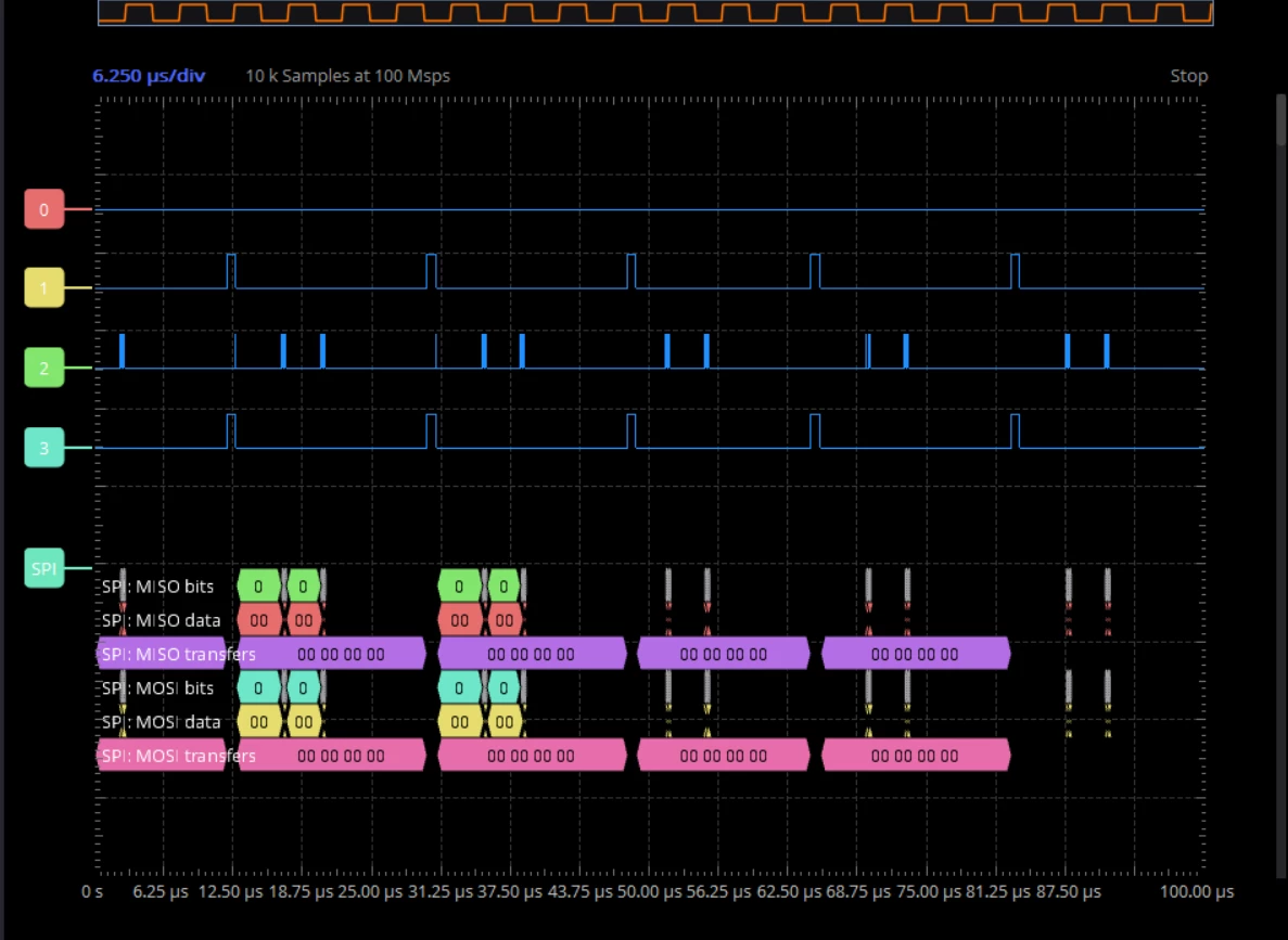

March 6, 2024
  1.  These are the signals I'm getting for STM32L562VET6 :
  2. 0 - MOSI, 1 - MISO, 2 - SCLK, 3 - CS0 - MOSI, 1 - MISO, 2 - SCLK, 3 - CS
     These are the signals I'm getting for STM32L432KC :
    0 - MOSI, 1 - MISO, 2 - SCLK, 3 - CS0 - MOSI, 1 - MISO, 2 - SCLK, 3 - CS Zoomed to view Clock signalZoomed to view Clock signal
    The code used both the MCUs are same with corresponding SPI handlers.
