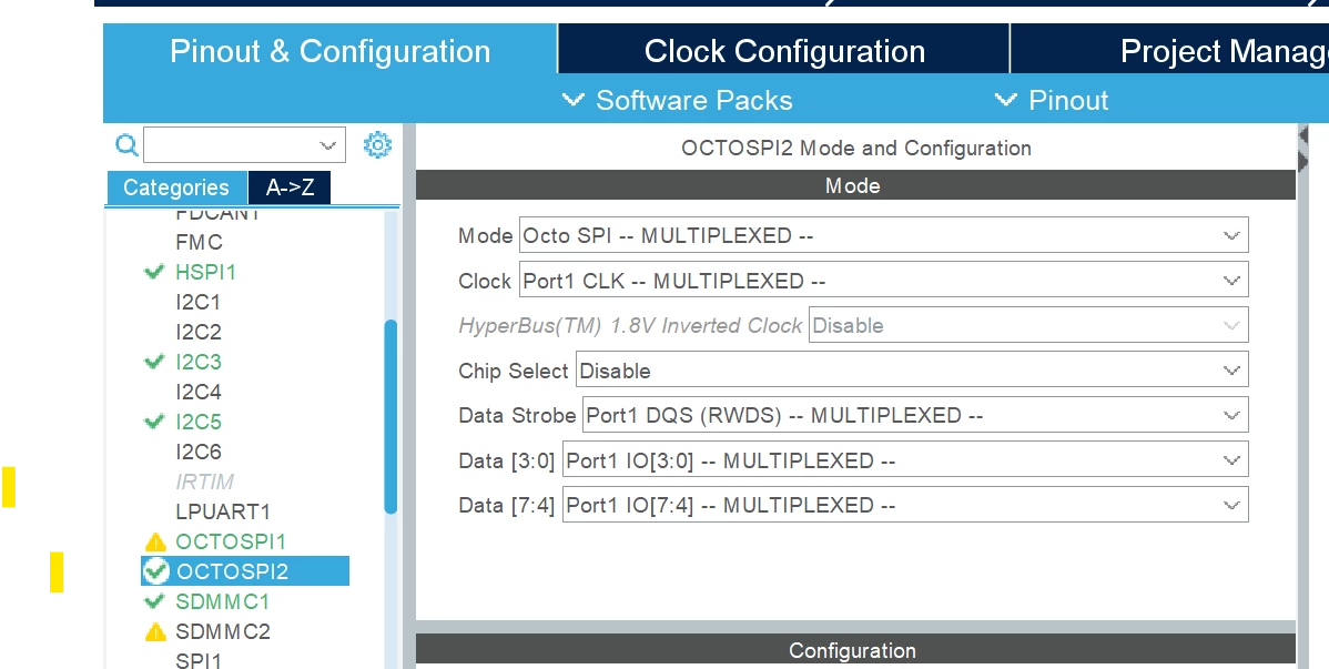

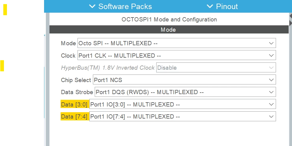

Here are the configurations for both OSPI1 and OSPI2 in STM32CubeIDE:
  • OSPI1 Configuration:
  • OSPI2 Configuration:
We tested the setup and observed the following:
  1. Using OSPI1, we can successfully perform read, write, and erase operations on the flash memory.
  2. However, when attempting to access the flash memory with OSPI2, we are unable to perform these operations.
->The Chip select pin is not configured for the OCTOSPI2 in OSPI2 configuration.
Is the issue solved when configuring the "Chip Select".

Unfortunately, the issue is not resolved after configuring the chip select for OSPI2.

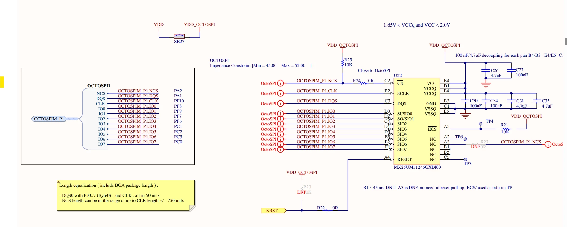

As per the schematic, the flash's chip select is connected to PORT1. When we configure the chip select option in OSPI2 as PORT1 NCS, we must disable it in OSPI1. In this scenario:
  • We can access the flash using the OSPI2 instance, but OSPI1 access stops working.
  • Similarly, when OSPI1 is enabled, OSPI2 access fails.
This means we can access the flash using either OSPI1 or OSPI2, but not both simultaneously. Since RWW functionality requires both instances to work concurrently, we are facing a roadblock.

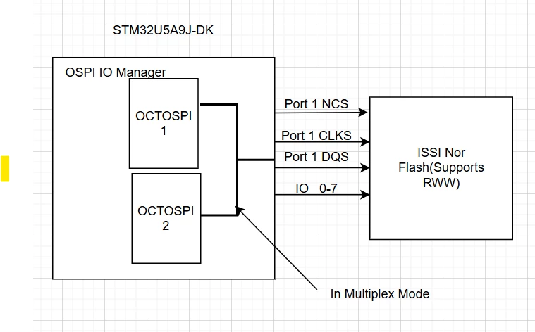

The example you shared is for a different development board. We tried replicating the configurations on our platform (STM32U5A9J-DK) but still cannot access the flash with both OSPI1 and OSPI2 instances simultaneously.
We suspect that we may be missing something in the configuration.
Could you confirm whether our current configuration aligns with the requirements for RWW? Additionally, is there any application project or reference specifically for STM32U5A9J-DK where RWW has been demonstrated to work?
Our octal SPI nor flash memory supports RWW. Can you confirm  the STM32U5A9J-DK supports RWW ?
We appreciate your guidance and support in resolving this issue.

As I mentioned in this post, the read while write mode needs a memory supported the RWW (have two bank), two OCTOSPIs interface (OCTOSPI1 and OCTOSPI2), OCTOSPI I/O manager.
The MX25UM51245G memory mounted on STM32U5A9J-DK doesn't support (RWW) the multi-bank like as MX66UW1G45G memory supports XIP and RWW (Read-While-Write) due to its multi-bank structure, which allows reading data from one bank while another bank is being programmed or erased.
Please take a look at  MX25UM51245G and MX66UW1G45G datasheets.

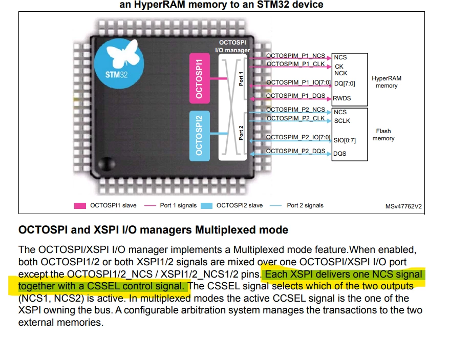

The RWW example provided by you is for the STM32H7S78-DK, which uses an xSPI IO Manager. However, our board (STM32U5A9J-DK) is equipped with an OSPI IO Manager.
Referring to the AN5050 (page 25):
  • The xSPI IO Manager delivers one NCS signal along with a CSSEL control signal.
  • It also allows selecting the same NCS for both XSPI_1 and XSPI_2 using the configuration.
XSPI Configurations for RWW example that you have given :
  • hxspi1.Init.MemorySelect = HAL_XSPI_CSSEL_NCS1;
    hxspi2.Init.MemorySelect = HAL_XSPI_CSSEL_NCS1;
    sXspiManagerCfg.nCSOverride = HAL_XSPI_CSSEL_OVR_NCS1;
However, the OSPI IO Manager does not provide these options:
  • When selecting Port1 NCS for OSPI1, it does not allow the same Port1 NCS for OSPI2.
  • Instead, we either need to disable Port1 NCS for OSPI2 or switch to Port2 NCS.
As a result:
  • If OSPI1 is configured to use Port1 NCS, OSPI2 stops working.
  • Similarly, if OSPI2 is configured to use Port1 NCS, OSPI1 stops working.
This limitation seems to make it impossible to access the ISSI flash memory from both OSPI1 and OSPI2 instances simultaneously in multiplexed mode using the OSPI IO Manager.
Could you please confirm whether our understanding is correct?

For my part, I have not found an RWW example with the STM32U5A9 device for the moment.
Could you please give more information about your use case? Is the firmware upgrade?
Maybe you can use two memories configured separately, not in multiplexed mode.
Could you try to configure OCTOSPI1 and the OCTSPI2 in multiplexed mode with the same chip select manually with software without using STM32CubeMX?
Let me know if the issue is solved or not.

We are able to Read and Write by controlling the  Chipselect in Software in Multiplexmode. Now we are trying to do RWW where we are trying to Write Using OSPI2 and Read using OSPI1 DMA .
Any specific Inputs on this? Do we need any changes in OSPI drivers to achieve this?
Sanath
