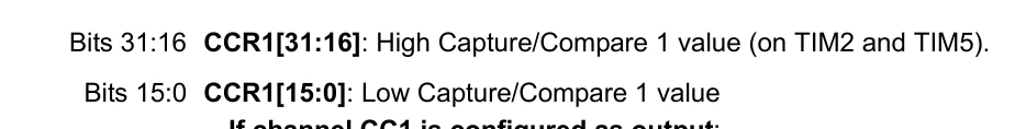

>So why does circular mode work for Timer 2 but not for Timer 3? All of the other settings are exactly the same.
Your settings are same, right, but the timers not .  Tim2 is 32b timer, Tim3 is 16b.
But you always try to write 32b , your data[x] , to the compare register, see manual:
So write 16b data to the 16b timer.
