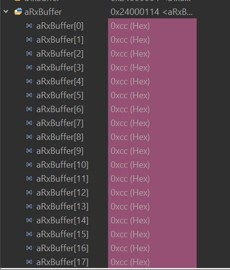

  2. Memory Mapped Read:
    • After switching to memory-mapped mode to read the NOR flash content, I find that all locations are filled with 0xCC.

  1. A screenshot showing the result in memory-mapped mode (all 0xCC values).

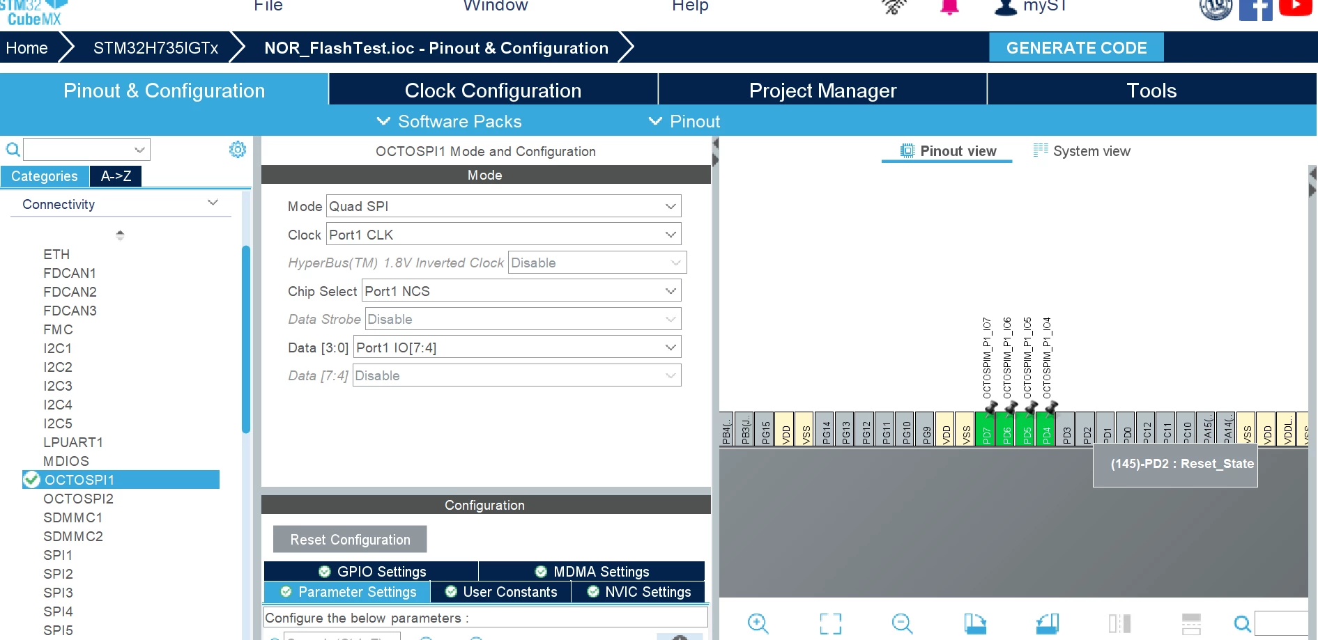

  1. Device Size Configuration:
    I have configured the device size in STM32CubeMX as 26 to match the 512Mbit size of the MT25QL512ABB flash memory.

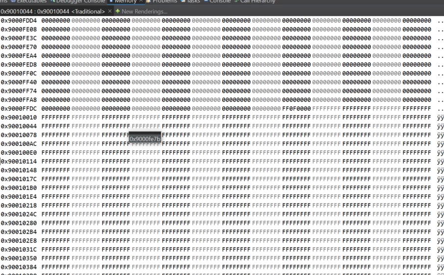

Observed Behavior:
  1. Programming Failure:
    I cannot program the first section of the NOR flash (address 0x0). After multiple attempts, I noticed:
    • Erasing Issue: The erase operation on the first section consistently fails. I verify the operation by checking both the status register and the flag status register.
    • Reading Issue in Memory-Mapped Mode: When I switch to memory-mapped mode and read the flash, I find that the entire first section is filled with 0x00.
  2. Unexpected Behavior:
    • Initially, the memory at 0x0 was not programmable but contained default values.
    • After some operations, I observed that the first section has been entirely overwritten with 0x00, even though programming operations were unsuccessful.
    • Further erase attempts on this section fail consistently.
