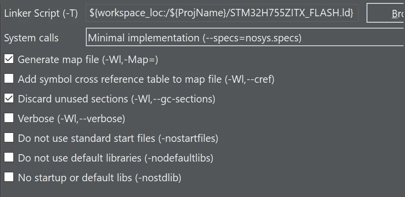

MJack.1
MJack.1Author
Jun 11, 2021 7:28 AM UTC
Thanks for the reply, TDK.
Both the M4 and the M7 projects are definitely using the correct linker script. If I change the section addresses in them, I can see while debugging that the addresses of the variables I have placed in those sections changes also. If I put a typo in there, it fails to build.
I'm not suggesting there's a big bug with GCC - but there's a problem somewhere, either with my linker or the generated project settings. Here are my linker settings (Nothing in the 'libraries' or 'misc' tabs) :
0693W00000BahZyQAJ.pngAny ideas where to look next?
Jun 11, 2021 2:12 PM UTC
I have no idea why the linker would be doing something other than executing your linker script. Could be missing something.
