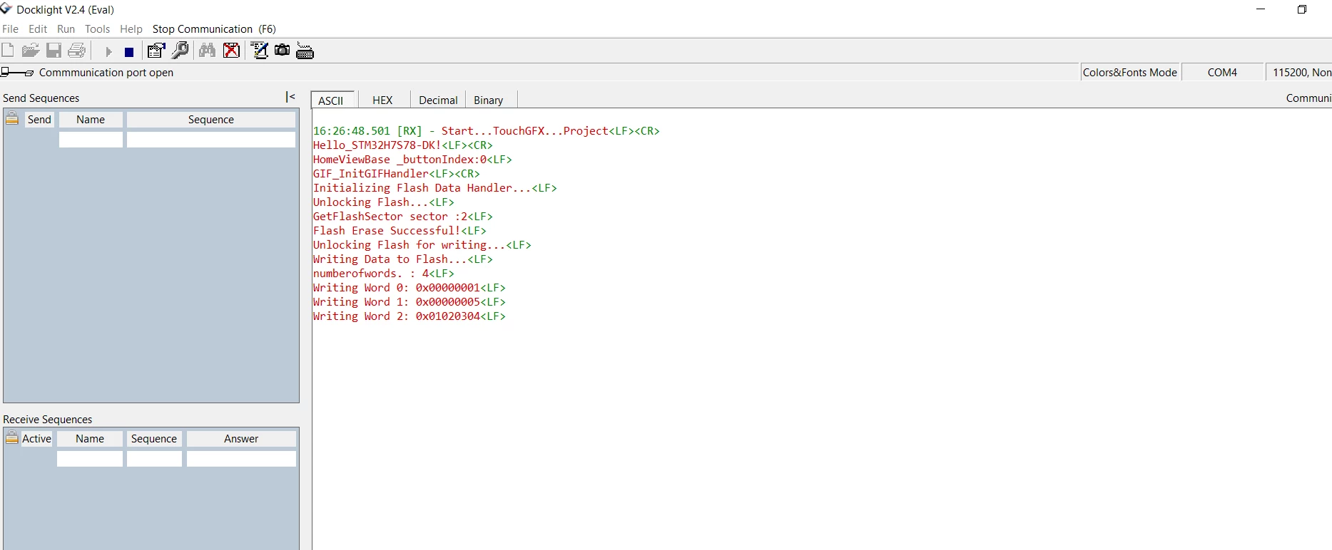

Thanks for all your help!
Using the start address 0x0800E000 fixed my issue, and the code is no longer getting stuck.
However, I noticed that the second word is always being read incorrectly. Below is the attached screenshot of my log.
I tried with different values but there is always unnecessary  4 come in value.
/Mehul

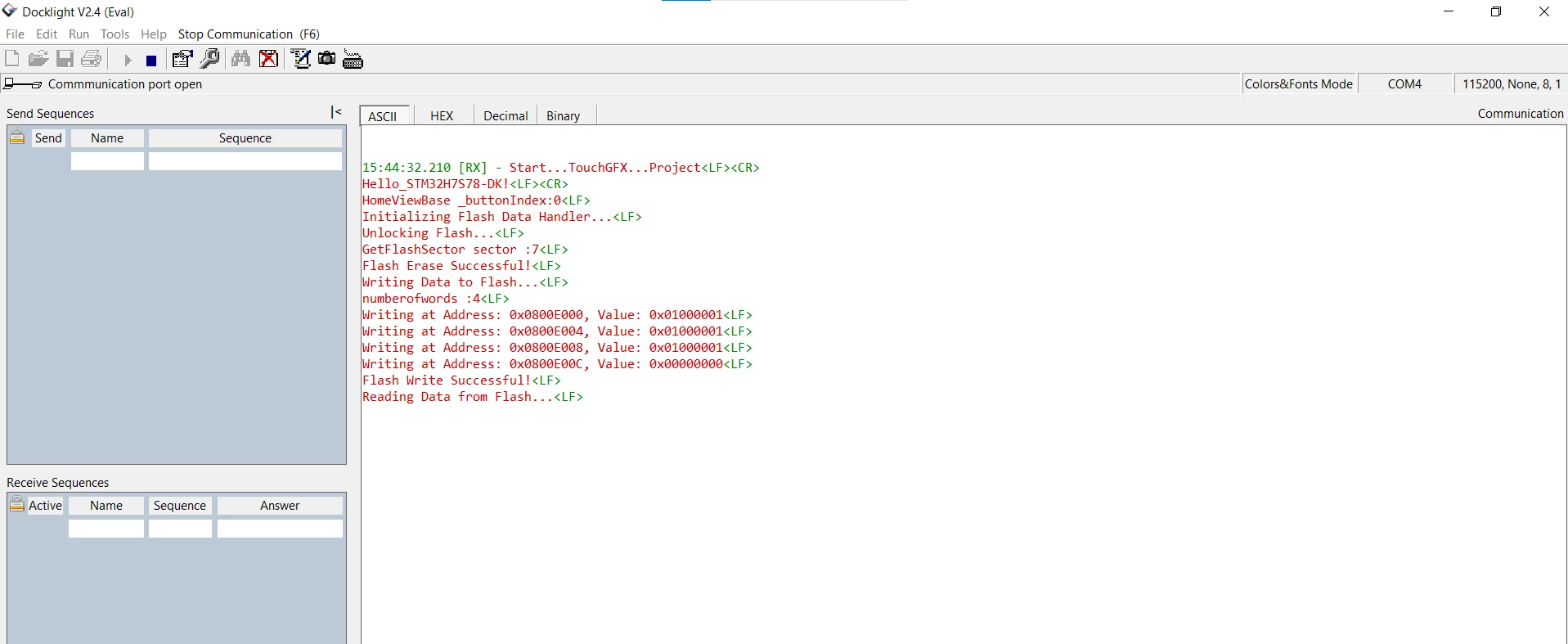

While trying to write different values i found that writing
 FH_FLASH_DATA_INFO flash_data_write =
 .name = 0x01000001,
 .model = 0x01000001,
 .firmware_version = 0x01000001,
above values cause my code stuck.
here is screen shot of log,

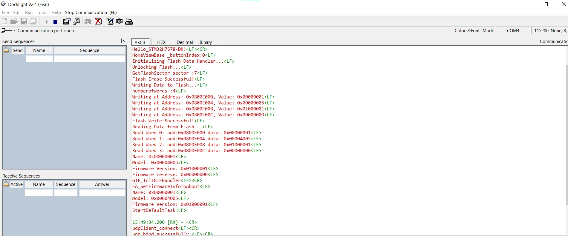

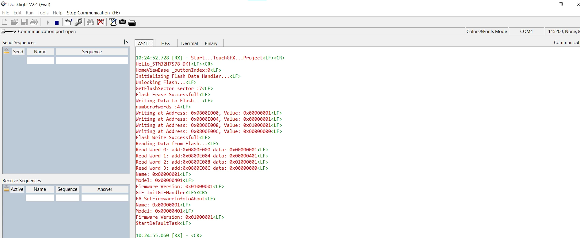

Again if i tried with this value it is running but still comes 4 in value,
 .name = 1,
 .model = 5,
/Mehul
