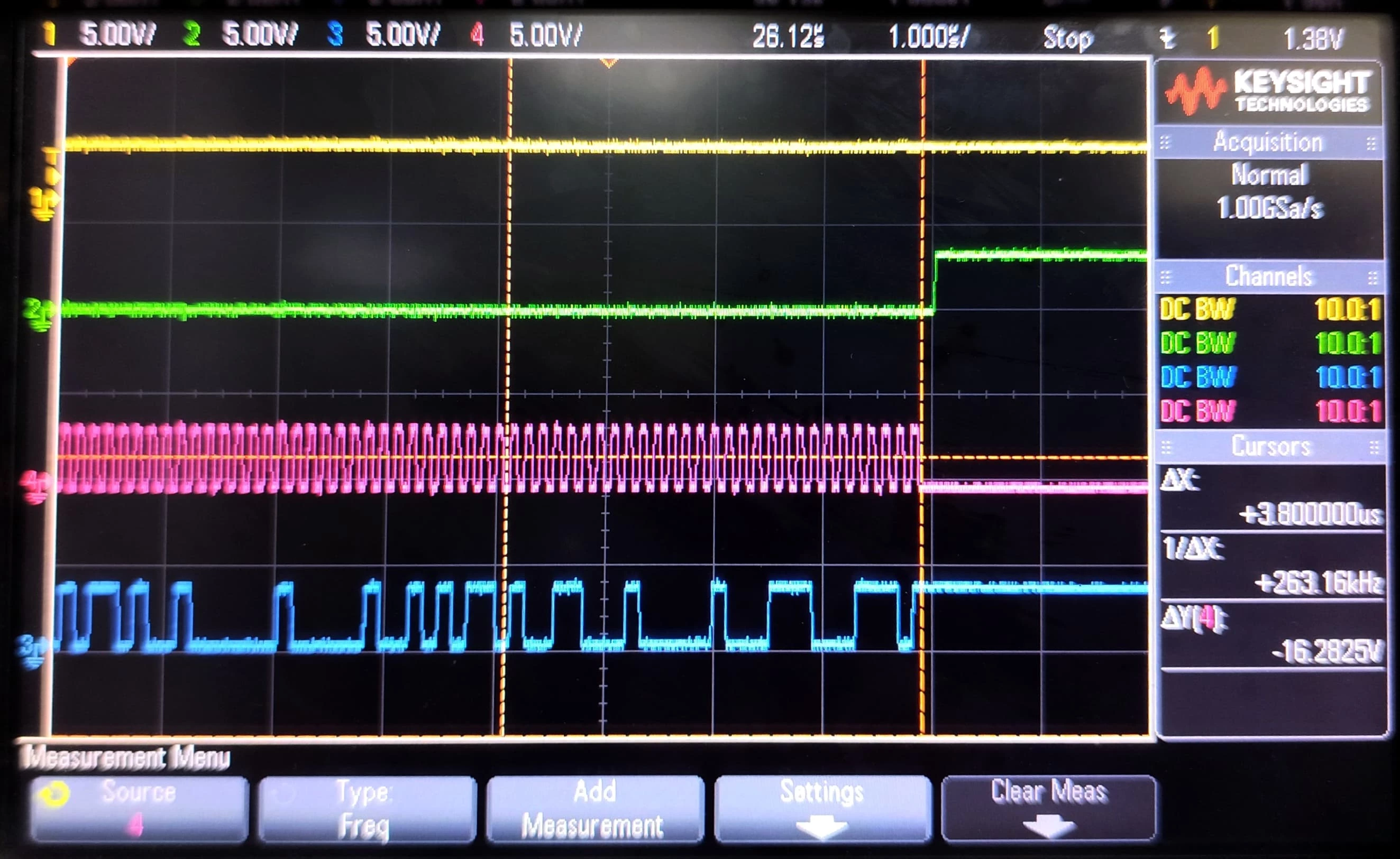

I have an STM32-L4P5DK connected to an external ADC, with SPI2 configured to read ADC samples on every falling edge of the DRDY signal. The DMA1 configuration is as follows:
DMA1 CHANNEL1: DMA_GENERATOR0
DMA1 CHANNEL2: SPI2_TX
DMA1 CHANNEL3: SPI2_RX
The DRDY pin is connected to EXTI1. On each falling edge of DRDY, DMA_GENERATOR0 generates a request to set the Chip Select pin low. The SPI_TX DMA request is synchronized with the rising edge of DRDY, so SPI_TX transmits dummy bytes to read the ADC data via SPI_RX DMA request, which is also synchronized with the EXTI1 rising edge. Once the SPI transmission is complete, I set the Chip Select pin high in the `HAL_SPI_TxCpltCallback` function.
The problem is that the Chip Select pin goes high before the SPI transmission completes. However, if I add a delay using a while() loop, the Chip Select timing shifts correctly.
Why is this happening, and how can I ensure that the Chip Select pin goes high only after the SPI transmission is completely finished?
void HAL_SPI_TxCpltCallback(SPI_HandleTypeDef *hspi)
HAL_GPIO_WritePin(CS_GPIO_Port, CS_Pin, 1); //callback function without delay
for the above function , I get the below output.
fig 1:

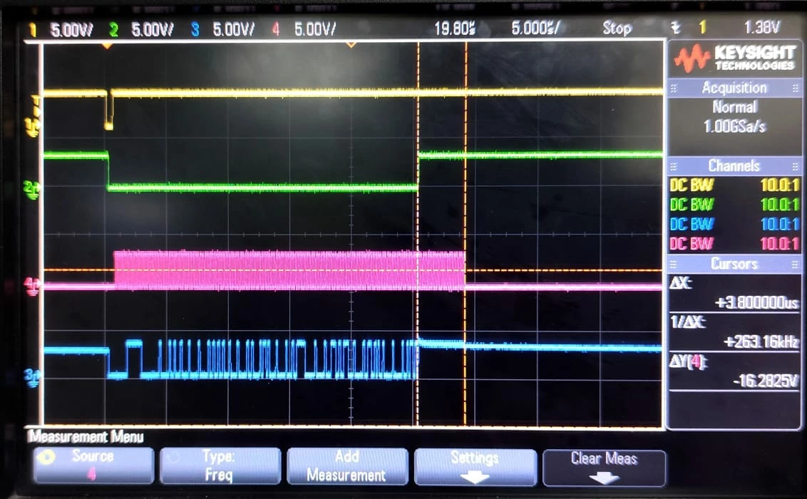

uint8_t i =21;
while(--i) // added delay to shift CS pin HIGH state
	__NOP();
fig2:
Scope output:
>> yellow - DRDY , green - CS , red  - SCK , blue - MOSI

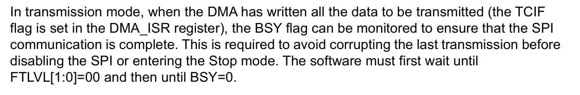

The DMA transfer completes when the last byte of data is sent to the peripheral. Since the peripheral has a FIFO, this happens before some bytes before the data is actually sent out. (Even without a FIFO, it would happen before the last byte is sent.)
Poll the SPI BSY bit and wait for it to be 0 before de-asserting CS.
This is actually covered in the RM:

July 26, 2024
Hi TDK,
I tried polling the SPI BSY bit, but it did not work. The CS pin becomes high even before the SPI transmission starts.
I have resolved the chip select issue by starting the timer in the `HAL_GPIO_EXTI_Callback` function. After 120us (since I am sampling at a rate of 8000sps, i.e., every 125 microseconds), I make the chip select pin HIGH in the `HAL_TIM_PeriodElapsedCallback` function. It works fine.
