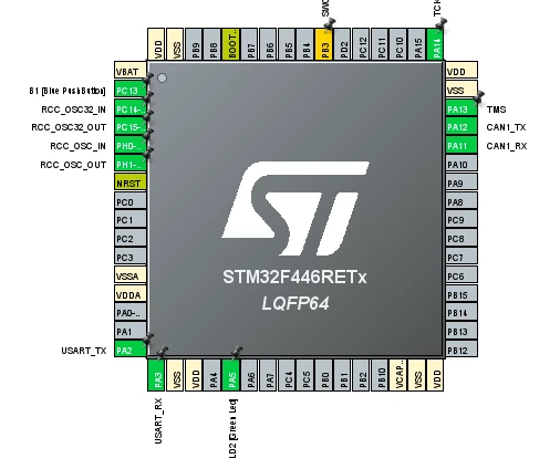

Hello, i am using f446re nucleo board and have been facing a problem for a while now. I need to establish a loopback CAN transmission and the debug mode allows me to find a bug in the CAN Start function: HAL_ERROR 0x1 returned everytime i attempt.
here is the while loop i am talking about:
while((hcan->Instance->MSR & CAN_MSR_INAK) != 0)
  if((HAL_GetTick() -tickstart) > CAN_TIMEOUT_VALUE)
    hcan->ErrorCode |= HAL_CAN_ERROR_TIMEOUT;
    hcan->State = HAL_CAN_STATE_ERROR;
    return HAL_ERROR;

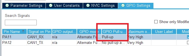

Configure CAN_Rx pin (PA11) in pullup mode:
7 replies
mƎALLEm
March 25, 2024
Could you please share your code or your ioc file if you're using CubeMx?
Share the GPIO pin configurations.
Erwan03Author
March 25, 2024
Thank you for your quick answer!
Here is the GPIO config from the .ioc

Erwan03Author
March 25, 2024
Thank you for your help. I don,t know how come this worked but it did.
