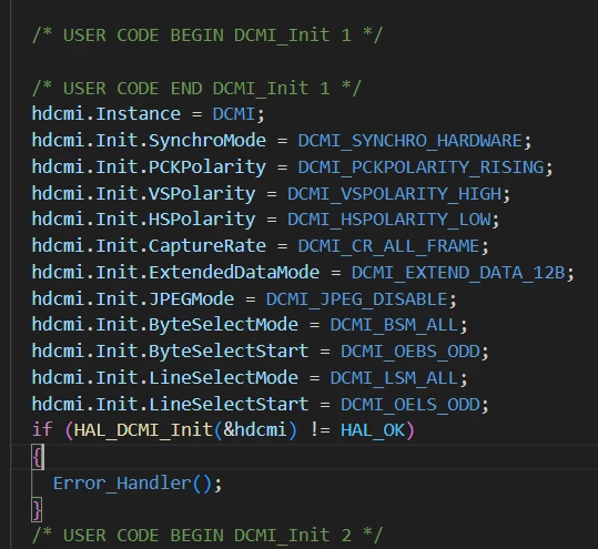

DCMI Configuration:
CopyEdit
hdcmi.Instance = DCMI;
hdcmi.Init.SynchroMode = DCMI_SYNCHRO_HARDWARE;
hdcmi.Init.PCKPolarity = DCMI_PCKPOLARITY_RISING;
hdcmi.Init.VSPolarity = DCMI_VSPOLARITY_HIGH;
hdcmi.Init.HSPolarity = DCMI_HSPOLARITY_LOW;
hdcmi.Init.CaptureRate = DCMI_CR_ALL_FRAME;
hdcmi.Init.ExtendedDataMode = DCMI_EXTEND_DATA_12B;
hdcmi.Init.JPEGMode = DCMI_JPEG_DISABLE;
hdcmi.Init.ByteSelectMode = DCMI_BSM_ALL;
hdcmi.Init.ByteSelectStart = DCMI_OEBS_ODD;
hdcmi.Init.LineSelectMode = DCMI_LSM_ALL;
hdcmi.Init.LineSelectStart = DCMI_OELS_ODD;
if (HAL_DCMI_Init(&hdcmi) != HAL_OK)
    Error_Handler();

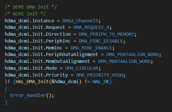

DMA Configuration:
c
CopyEdit
hdma_dcmi.Instance = DMA2_Channel5;
hdma_dcmi.Init.Request = DMA_REQUEST_4;
hdma_dcmi.Init.Direction = DMA_PERIPH_TO_MEMORY;
hdma_dcmi.Init.PeriphInc = DMA_PINC_DISABLE;
hdma_dcmi.Init.MemInc = DMA_MINC_ENABLE;
hdma_dcmi.Init.PeriphDataAlignment = DMA_PDATAALIGN_WORD;
hdma_dcmi.Init.MemDataAlignment = DMA_MDATAALIGN_BYTE;
hdma_dcmi.Init.Mode = DMA_NORMAL;
hdma_dcmi.Init.Priority = DMA_PRIORITY_HIGH;
if (HAL_DMA_Init(&hdma_dcmi) != HAL_OK)
    Error_Handler();
__HAL_LINKDMA(&hdcmi, DMA_Handle, hdma_dcmi);

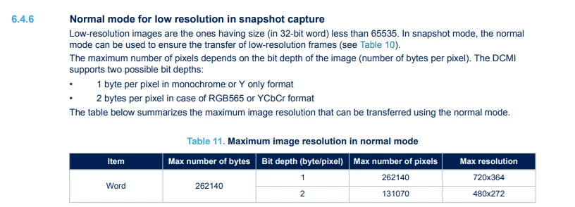

Hello @Vaishak-hoomanely  and welcome to the community,
What is the image resolution?
Could you try with a low image resolution like 480x272?
I recommend you to take a look at AN5020 may help you.
Thank you.

February 25, 2025
Thank you @Kaouthar for your response.
We are already using a lower resolution - our current configuration is 320x200 with 12-bit data format (not 480x272). Even at this reduced resolution, we're encountering issues with image quality, not memory limitations.
Here's a summary of our current setup:
Camera: AR0144 CMOS sensor
Resolution: 320x200 (center crop from full sensor)
Data format: 12-bit with DCMI_EXTEND_DATA_12B
DCMI configuration:
VSPolarity = DCMI_VSPOLARITY_LOW
DMA in circular mode with word alignment

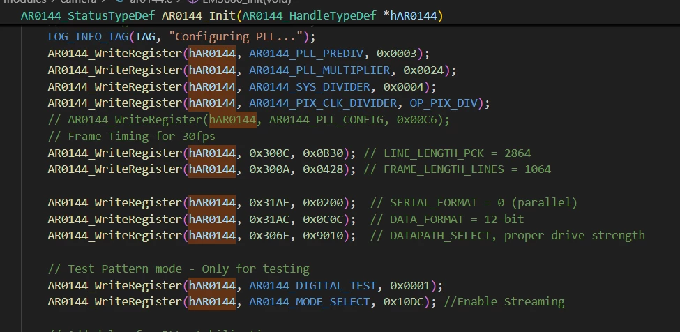

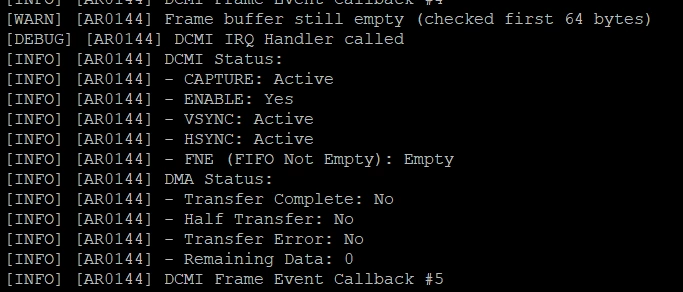

I have made progress in my AR0144 integration and moved past the PLL lock issue.
Current Issue: Frame Buffer Remains Empty :
Please check the log file that i have attached along with the DCMI DMA configs.
Also i am keeping the ar0144 initialization setting since i have added changes to overcome PLL not locking issue.
