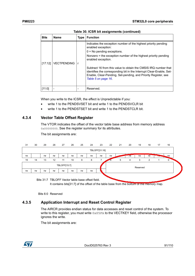

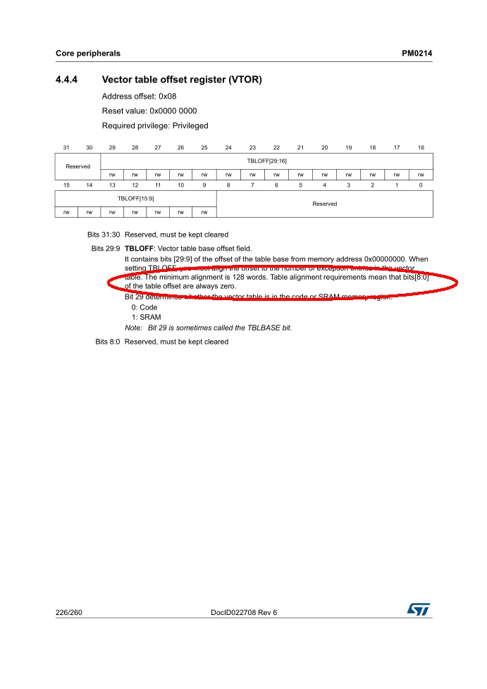

    waclawek.jan
    Apr 30, 2018 5:09 PM UTC
    Posted on April 30, 2018 at 19:09
    #define APPLICATION_ADDRESS  (uint32_t)0x08002030
        // Reconfigure vector table offset register to match the application location
       SCB->VTOR = APPLICATION_ADDRESS;
    You didn't care to tell us what STM32, so I assumed Cortex-M4:

    waclawek.jan
    Apr 30, 2018 11:11 PM UTC
    Posted on April 30, 2018 at 23:11
    Im using a STM32L073 chip.
    And then how hard is it to look it up in the respective Cortex-M0+ Programming Manual?
    So, adjust the position of the table accordingly to the given granularity of 128 bytes.
