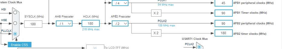

And based on F769 datasheet
TIM1 is linked to APB2 not APB1, so can you precise your APB2 timer clocks frequency?
and are you sure that your frequency is 180MHZ
because APB1 max frequency is set to 54MHZ and APB2 is 108MHZ

February 3, 2026
Hello Gyessine,
Sorry there I have mentioned APB1 instead of APB2. so my timer1 channel4 is connected on APB2 which is running at 180MHZ.
