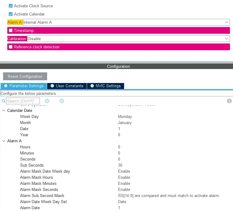

I try to configure a STM32C031K6 to generate an interupt every seconds using RTC Alarm A (RTC clocked by 32.768KHz crystal).
I am working on STM32Cube IDE 1.15.1. First issue was that the device configuration tool does not generate any code regarding the Alarm Sub Second Mask (nothing change in the MX_RTC_Init() if you change the parameter).
Here is my settings :
Here is the code generated, with the 5 last code lines entered manually :

MX_RTC_Init() is called at startup. If I place the following lines in my main loop, I can see the output test pin toggled every seconds :
if (LL_RTC_IsActiveFlag_ALRA(RTC))
LL_RTC_ClearFlag_ALRA(RTC);
LL_GPIO_TogglePin(TP15_GPIO_Port, TP15_Pin);
But if I removed it and move the toggled in the interrupt handler, the output is no more toggled :
void RTC_IRQHandler(void)
/* USER CODE BEGIN RTC_IRQn 0 */
/* USER CODE END RTC_IRQn 0 */
/* USER CODE BEGIN RTC_IRQn 1 */
/* USER CODE END RTC_IRQn 1 */
In debug mode, I check, the interrupt is never triggered. Another interupt (Timer1) is working fine.
Can anyone help me find what I missed ?
