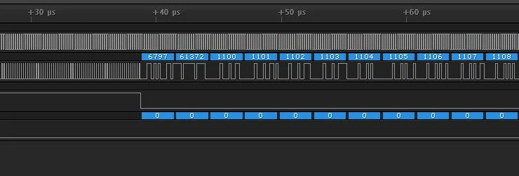

Hi
First I will give info about my project.
I am generating PWM using timer, then SPI using Full Duplex slave mode and a GPIO pin.
PWM is connected to SPI sclk and GPIO is connected to NSS.
I am transferring data from 1 to 550 and 1100 to 1650. Now the problem is the first block of data i.e 1 to 550 going well. when I restart the SPI transfer I see some 2 bytes of junk data that is transferring through SPI. Below is the code and waveform.
Please suggest me and let me know where I am going wrong.
