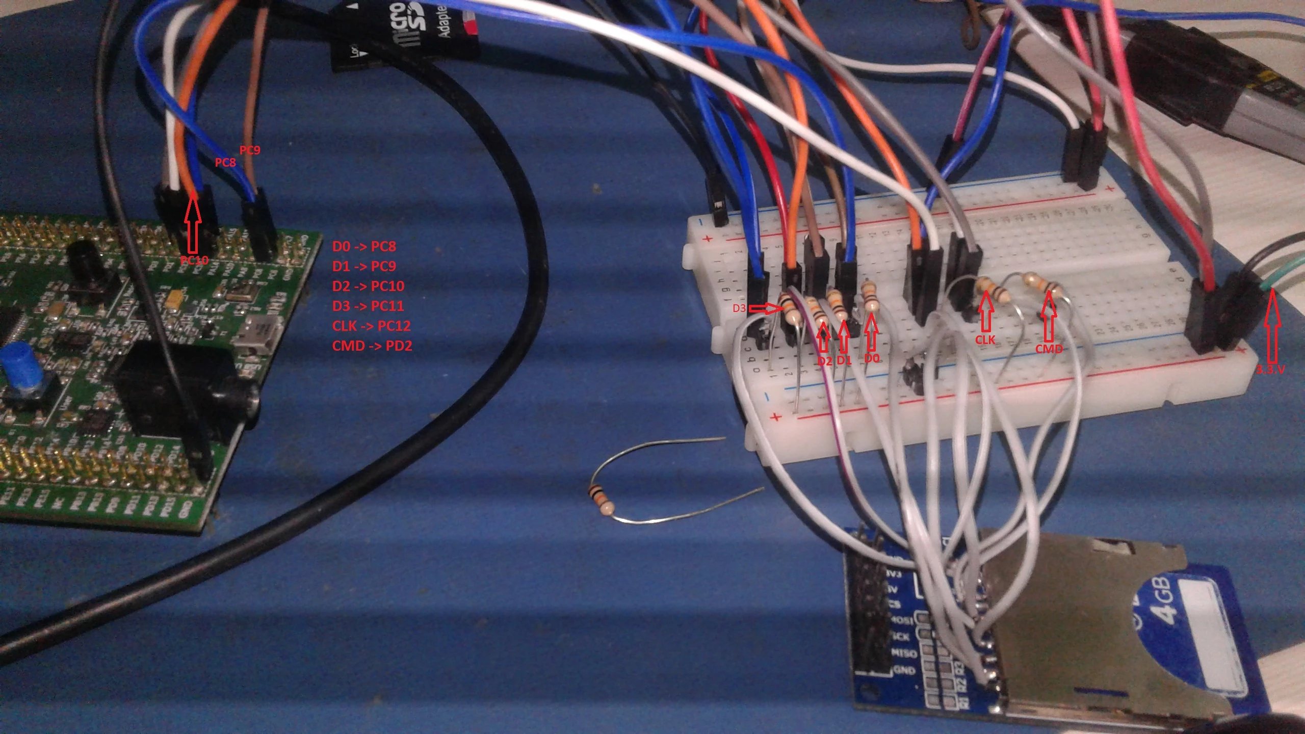

I am using stm32F411RE discovery kit. i generate a code with the cubeMX4.25, the 4GB SDHC card is working fine but when i tried with the 256MB SD Card it was not working. I am getting error 'FR_NOT_READY' in f_mount function.
Other SD Cards (4GB and 16GB) are successfully mounted and file can be written/read.

Durmil Makwana
Jun 30, 2018 10:34 AM UTC
Posted on June 30, 2018 at 12:34
We Found a problem with SD Card Socket there is all data pins are shorted in the module. now we can read write in 4GB and 16GB card with DMA and Without DMA using 4bit and 1bit modes. 4GB(SDHC class-4) Card is working at 2MHz frequecy and the 16GB(class-10) Card is working at 500KHz.
In the Hardware we have pulled up the lines with the 47K resistors.
But still the problem is same that the 256MB Card is not working at any frequencies - (from 300KHz to 8MHz).
Is there any changes required specific for 256MB Memory Card.
We are using this memory card to store the data.

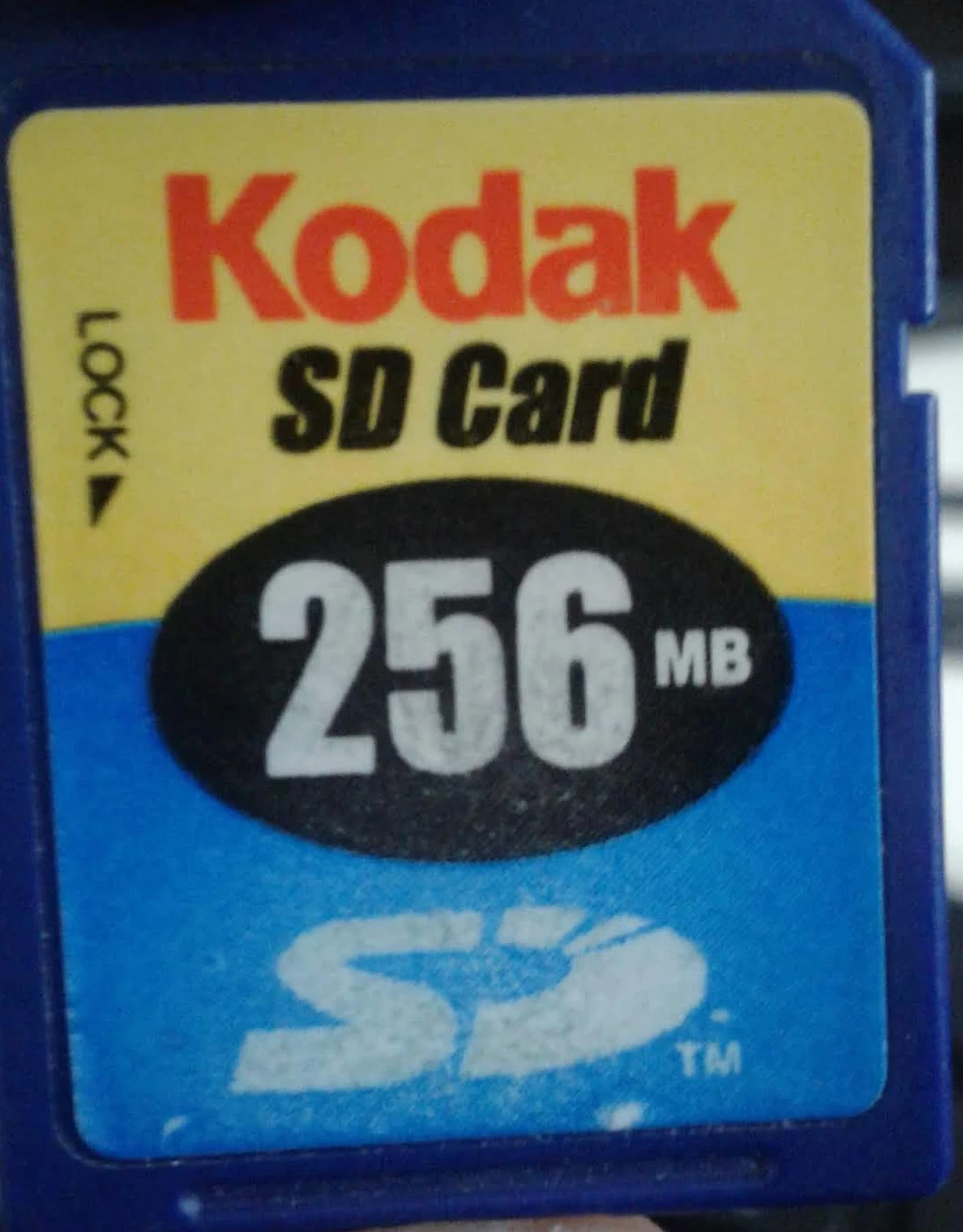

I would like to update the current status of the issue. We have three 256MB cards and out of three cards one card is working perfectly with the firmware. One card gives an error FR_NO_FILESYSTEM and another one gives an error FR_DISK_ERR.

Durmil Makwana
Aug 2, 2018 5:54 AM UTC
We gave it the CMD55 until it did not return HAL_SD_ERROR_NONE So it give HAL_SD_ERROR_NONE after 3 or 4 tries.
all three cards are working in the PC. But only one card is work with the Discovery kit. all the cards are of KODAK brand.
All three cards are formatted with the FAT16 file system with the 16k and 4k Allocation unit size.

Hello All,
I am working with Durmil,
To summarize again: we have three 256 MB SD Card of Kodak brand. Out of these three, only one 256 MB SD Card is working with 4-bit SDIO.
We found that using 4-bit SDIO, MBR sector is not read correctly from one SD Card. Till now it is observed that while reading MBR (located at sector # 0x3F) in this SD Card, 21st Byte's LSB 4-bits of are missed and replaced by next byte's MSB 4-bits. So, it affected bits of all next bytes to be shifted ahead. After some bytes, it again misses 4bits LSB. This happened almost 3-4 times for reading 512 bytes of MBR sector. Hence, CRC is not matching. So, it is giving FR_NO_FILESYSTEM as it has not found valid MBR.
We have tried using 1-bit SDIO with this non-working SD Card and it works fine! Now all three 256 MB SD Cards are mounted, opened and file can be created with with some text using 1-bit SDIO.
So, now question comes - cannot all 256 MB SD card work via 4-bit SDIO? Should we use only 1-bit SDIO for 256 MB SD Card to make sure that our firmware will communicate successfully with all 256 MB SD Card?
FYI: 16 GB is working via 1-bit SDIO and 4-bit SDIO.
We still prefer to use 4-bit SDIO, if we can found reason and solution. If not, we have option of 1-bit SDIO.
Thanks and Regards.
