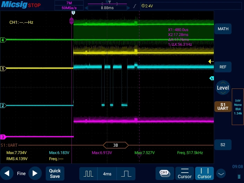

ISO7816 smart card have ATR only 1 byte 0x3B (ST8024CDR + STM32G030K6TX) missing/not work
  • May 31, 2023
  • 0 replies
  • 1013 views
ST8024CDR
I have problem for reset smart card after smart card return (ATR) can received 1 byte is 0x3B
Parameter
OSC = 4MHz
CLKDDIV = 4
Card is type T0 and support Max speed 5MHz
Code start reset
HAL_GPIO_WritePin(RST_UC_GPIO_Port, RST_UC_Pin, GPIO_PIN_SET);
HAL_GPIO_WritePin(CMDVCC_UC_GPIO_Port, CMDVCC_UC_Pin, GPIO_PIN_RESET);
_legacyfs_online_stmicro_images_0693W00000blCDBQA2.png CH4 <- Clock 1 MHz
CH1 <- VCC
CH2 <- Data
CH3 <- Reset
