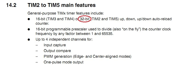

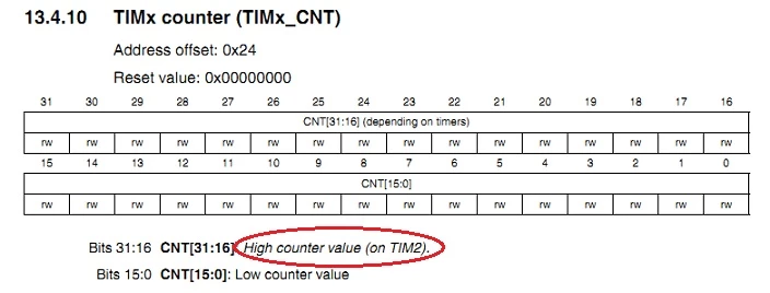

I noticed this in the user manual.  It also applies to the ARR and CCRx registers.

    Try this one:

    Rene is talking about the STM32F100xx manual, which does cryptically mention a 32-bit register set for TIM2, but only in the register descriptions. Everywhere else in the document it talks about 16-bit registers, and the library code does not special case TIM2 in any releases I've seen.
    It looks like it would be pretty easy to confirm/deny/validate if one bothered to poke at the registers, and stick a scope on the output.
    Release 4 of the manual does not have the same TIM2 32-bit reference, but older ones do.

    Looks like someone did a quick copy-and-paste from the STM32F20x UM.
