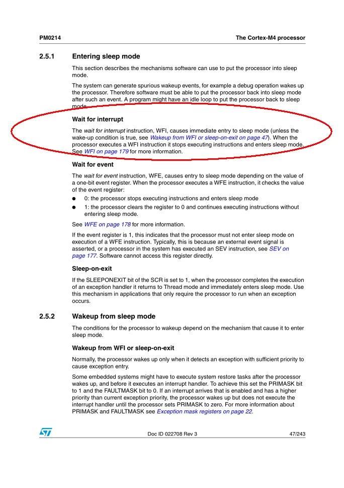

I am implementing a data save procedure when power fail is detected and want to shut down as much stuff as possible to give myself the most time to copy some data into FLASH.
Shutting down the CPU has many modes which are quite complicated. I have been reading the RM and various appnotes. Googling around shows a lot of people are having problems.
Is this a right way to do it? It never needs to come out of it, and it must not come out of it for any interrupt
CLEAR_BIT(PWR->CSR, 0x00000100U);		// disable WKUP pin, just in case
		#define portNVIC_SYSTICK_CTRL_REG ( * ( ( volatile uint32_t * ) 0xe000e010 ) )
		portNVIC_SYSTICK_CTRL_REG = 0UL;		// stop systick, just in case (also stops RTOS)
		SET_BIT(PWR->CR, PWR_CR_PDDS);			// select standby mode
		SET_BIT(SCB->SCR, ((uint32_t)SCB_SCR_SLEEPDEEP_Msk));	// Set SLEEPDEEP bit
		__WFI();								// request "wait for interrupt"
Some of the above is out of HAL_PWR_EnterSTANDBYMode().
I don't get what __WFI is supposed to do.
Thank you for any help or suggestions.
0693W00000KcNy0QAF.pngJW

Thank you. I didn't know that manual existed. Still, the answer is not simple. Quoting, page 48,
"Normally, the processor wakes up only when it detects an exception with sufficient priority to
cause exception entry."
and that could be a whole lot of things.
I wondered if one has to disable ALL interrupts before doing WFI. I am disabling WKUP and Systick.
All interrupts cause wakeup, so you have to disable all those you don't want to cause wakeup. It's your program, you surely know what interrupts you have enabled. You would want to "deinitialize" (stop, disable, whatever) most of peripherals causing interrupts, before entering sleep, anyway.
Alternatively, use WFE. Events can be caused by interrupt sources which go through EXTI, see External interrupt/event line mapping subchapter of EXTI chapter in RM, as enabled in EXTI_EMR register.
