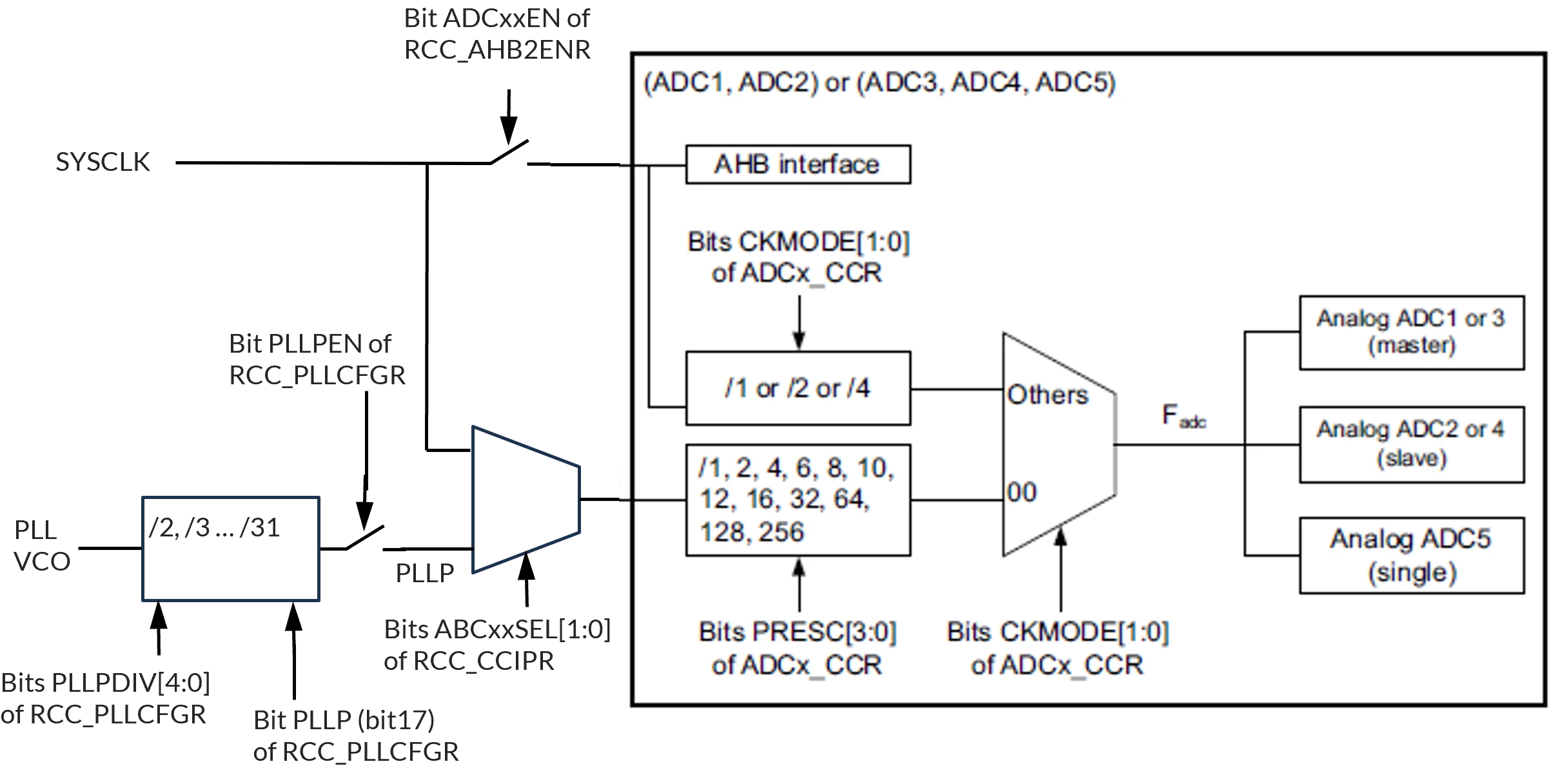

Is this schematic right regarding the ADC clock for STM32G4xx MCUs?
I have used some time to figure out to use the ADCs for a couple of Nucleo STM32G4xx boards. In particular I liked to be able to make use of the asynchronous clock. I found out by some trials and errors to get the right RCC settings for that.
In RM0440 you got a ADC clock schematic figure 83 page 597. I have tried to enlarge this schematic a bit regarding the RCC controls like this:
Can you agree to this schematic?
These functions can help configure RCC for the other ADC clock input:
__HAL_RCC_ADC12_CLK_ENABLE()         Enables clock to AHB interface
__HAL_RCC_PLLCLKOUT_ENABLE(RCC_PLL_ADCCLK); Enables clock to PLLP
I did not find a function outside the big HAL RCC init data structure to set the bits ABCxxSEL[1:0] of RCC_CCIPR, so I did that bare metal.

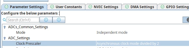

It should be easy to set in Cube :

BackflipAuthor
Aug 9, 2026 1:18 PM UTC
With reference to the schematic in the start of this thread, I found a HAL function to set the MUX in front of the each ADC block without affecting the whole RCC structure. It is to set the Bits ABCxxSEL[0:1] of RCC_CCIPR.
You use
__HAL_RCC_ADC12_CONFIG()
or
 __HAL_RCC_ADC345_CONFIG()
with a parameter of
RCC_ADC12CLKSOURCE_NONE   (this is the default)
or
RCC_ADC12CLKSOURCE_PLL
or
RCC_ADC12CLKSOURCE_SYSCLK
It seems the interest to verify this schematic got limited interest (I got no answers to question). Will it be normal for users in this community to leave the question open?

AScha.3
AScha.3Best answer
Aug 9, 2026 6:32 PM UTC
So…
>I am new here and to these STM32 processors
maybe you should ask : how to use this and the CubeIDE and what you want to do …
I wrote in the beginning: you can set the clock for ADC in CubeMX - so why not just doing it ?
Or is it just to find out something in the internal structure of a soc , thats only valid for exactly this version ? why ?
OHhhh - i just see, you playing with Arduino, ok, now i understand better, why you ask.
 + in Arduino you cannot control these kind of chips anyway (i know, because i tried...), you can get in the best-case scenario a dont-know-why-it-works-now mix of simple Arduino commands and HAL-library snippets.
Just believe me: Arduino is perfect to get something running in view minutes, if a good library doing, what you want.
But if you want something, thats not covered by ready made libs and functions, and want/need go to the limits that such a complex SOC (not just cpu, its a System On Chip)  you have to use the tool of the manufacturer , here STM .
​​​​​​​ + so finally about your first question: yes, your schematic looks ok . :)
